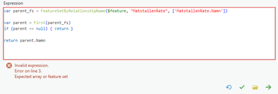

Thanks Johannes, but sadly it doesn't work.
This error occurs. Any suggestions to what might be the issue?
I'm new to Arcade, and I've been trying to find the solution for days now, but I'm stuck.

  • Try using the simple name of the field (like you did in your code above):
var parent_fs = FeatureSetByRelationshipName($feature, "Matstallen_Rate", ['Namn'])
  • Make sure that "Matstallen_Rate" is actually the name of the relationship class, not the name of the parent feature class!
  • Try using the full name of the relationship class: "DatabaseName.DataOwner.Matstallen_Rate"
