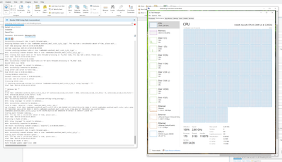

E.g. in the screenshot below, I am using a concurrent.futures.ThreadPoolExecutor to execute up to 44 threads with SQL statements to generalize data on the database using PostGIS commands. As you can see from the inset of the remote desktop to the server, this pushes the PostgreSQL database to a full 100% CPU usage, without processes.
