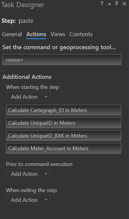

So I'm trying out some tasks in Pro to speed up my workflow.
I created a simple task that copies 3 attributes from one selected point feature to another one.
The first step does the copying, the second step pastes the attributes into a different (selected) point:
When I run the task, it takes about 4-5 minutes (!!) to finish. Then I looked at the task history, and the result notes that the task was finished in 10 seconds (!?!?)
Why on earth does it take so long to copy attributes and calculate fields? And why does the task history tell me that it took 10 seconds to complete, when it actually took over 4 minutes?
What am I missing here? Is the task set up improperly, or is this normal ArcPro behavior?
Thanks for your input!
Marc
