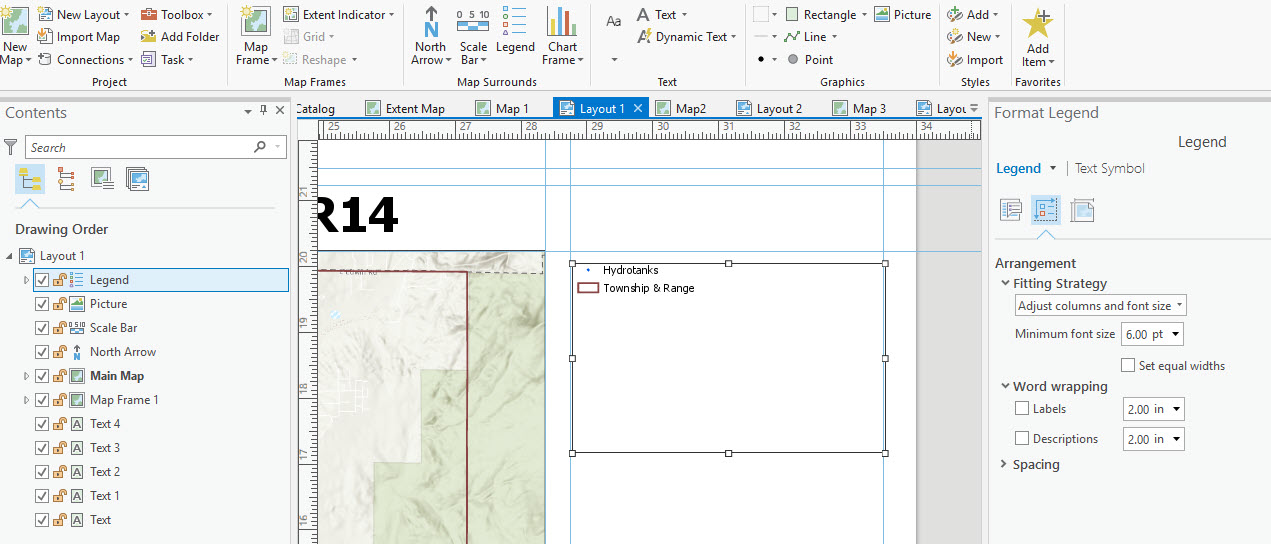

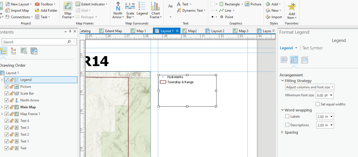

I am working in ArcPro version 2.0.1 and making some maps.  When I add a legend the symbols and labels are small.  Also, when I resize the legend box the symbols and labels will not adjust to fit.  In the legend properties under arrangement , the fitting strategy is set to "Adjust columns and font size."  What needs to be changed so that the columns and font size adjusts automatically?  Attached are images of the legend with different sizes.

What I am hoping to find is something in the fitting strategy that will allow the legend items to expand to fit the entire legend.  Currently they will expand to a point and then stop.  Below is a series of screen shots showing the increase until they don't.  I could manually configure each layer size for now, but it would be a time saver if I don't have to do this every time.

I have experienced this issue very recently. In keeping with what has been said you must select the individual element you want to adjust and adjust both the TEXT and PATCH (Symbol) for the element selected. I found the attached link to be useful. See the Update Legend Patch Size Section.
