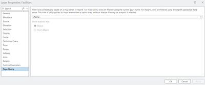

Hello, you can do this using Page Query. Right-click the layer in your table of contents, click on Properties, at the bottom left you'll see Page Query.
RobertMatthewmanCTCLUSI_0-1775661584581.pngRobertMatthewmanCTCLUSI_0-1775661584581.png

Yep, an hour after posting this, I found my solution and did not delete this post LOL What you said is what I did and it worked like a charm.!
