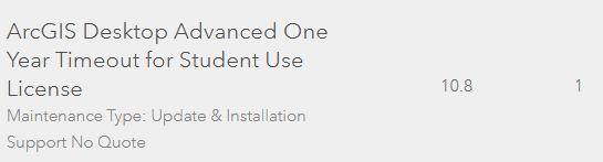

I have this license to be precise and it is still valid until August 2020.

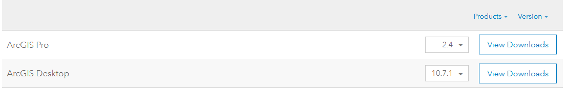

My downloads include ArcGIS Pro and ArcGIS Desktop

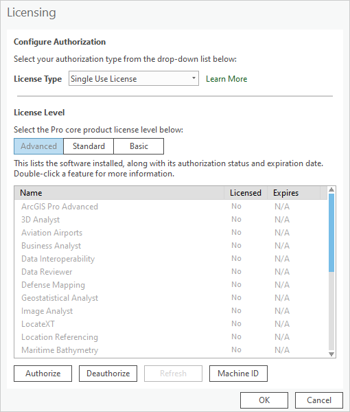

I have tried de-authorizing and re-authorizing the program through ArcGIS Pro, but it has not changed the status of ArcGIS Pro Advanced on the authorization screen:
When I try to authorize using my valid license, it tells me the following:

In general, ArcGIS Pro and ArcGIS Desktop use completely different licenses and follow different naming conventions. An advanced license in ArcMap is called "Desktop Advanced" while an advanced license in Pro is called "ArcGIS Pro Advanced." I am not positive if Student licenses work the same way, but this may be the root of the issue- it looks like only the desktop licenses are authorized on your ArcGIS Administrator.
By default, ArcGIS Pro licenses are distributed as Named User licenses- they belong to an ArcGIS Online Organization and are assigned to specific usernames via that Organization. When you purchased your student license, did you by chance receive an email from customer service about activating an ArcGIS Online subscription? Details on this can be found below:
