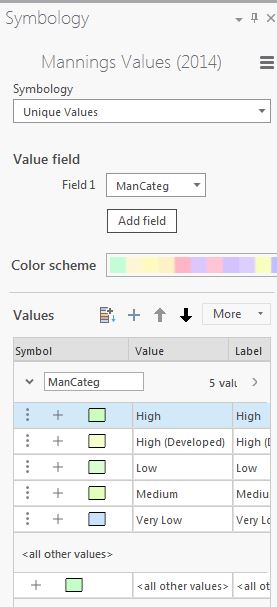

If you are using Unique Value for your Symbology in Pro, how can you remove just 1 or 2 values?  I see how to Remove all values, but I do not see a way to remove individual values.
TonyHowze
If you right click on the item you get an option to remove.  Make sure to click on the value or label box.
AdrianWelsh
MVP Honored Contributor
Like what Tony said, right click on the item, and click on remove. Here is a screenshot
