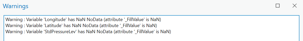

I want to add a multidimensional voxel layer to ArcGIS Pro. When I do so, I'm getting this error:
I'm not sure why this happens.
First, when I print out the netCDF4 Dataset in Python, I get this, where none of the fill values (marked FV) are NaN.

Now below is the dataset at the variable I'm interested in. Second, the fill_value that I hard-coded into the dataset is 4.65079211e-08, which you see in the first entry of the first three sub-arrays. Third, the fill_value you see at the bottom is 1e+20. Neither of those are NaN.

So why is ArcGIS Pro telling me that my variables have no data and my fill values are NaN?
I haven't been able to find anything on the internet, ArcGIS Pro's docs, or NetCDF's docs about this. I'd really appreciate any help!
