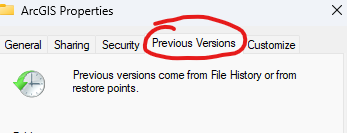

I have had his same issue - On my end I have noticed that this occurs since upgrading to Windows 11, and if I leave a project idle.
I was running a cache over the weekend. The cache finished building, (18+ hours) but I could not save the project file. I could not save even as a new project and when I closed the project file had erased. Also, no backup. I noticed that before closing, the project said "back up in progress". I suspect there is an issue with the operating system since, at least for me, this issue did not occur with windows 10.
One bright spot --- I was able to restore my .aprx file using the "previous versions" tab in windows file explorer:
