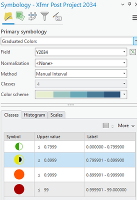

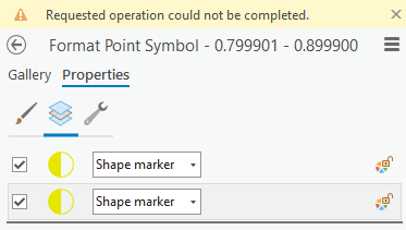

I am experiencing this problem in Pro 3.3.5. I have a point layer using Graduated Colors Symbology. Each class has two symbol layers. When setting the properties of the second class the 'Requested operation could not be completed' shows up.
1 of 4 classes set, working on the 2nd class:
Attempt to create a new symbol layer on second class:
