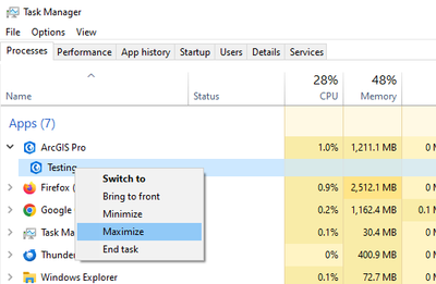

Another thing to try is to open the Task Manager, right click on the program and select Maximize.

It minimizes and maximizes perfectly well, but it returns to its offscreen position. I can very briefly catch a glimpse of the window as it maximizes and expands off to its Windows purgatory.

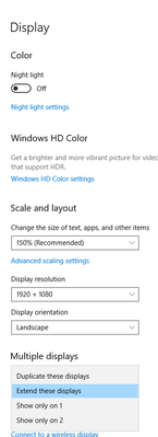

Go to your display settings and from the display option you can choose "show only on 1" under the "multiple displays" settings. This should push all of the open programs to one monitor. Afterwards you can change the settings back to your current setup.

I thought for sure this would do it. No luck!
