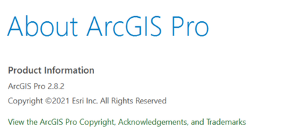

Great. I just got a new laptop so I’ll install 2.8.2 today!

I upgraded to 2.8.2 yesterday.  Had a little hiccup with a clone but I got past this morning.

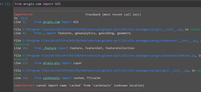

Please help - I am working in ArcGIS Pro 2.9.2 and have installed the 2.9 Deep Learning Libraries. In attempting any import function, I get an error: One example:
Another:
What is this file it is looking for in the cachetools file? (I am not well-versed in Python, so this is massively confusing) I am attempting to trains a Deep learning model in a Notebook and cannot get past the first cell, which uses a function it accepted before. Thanks for any help.
