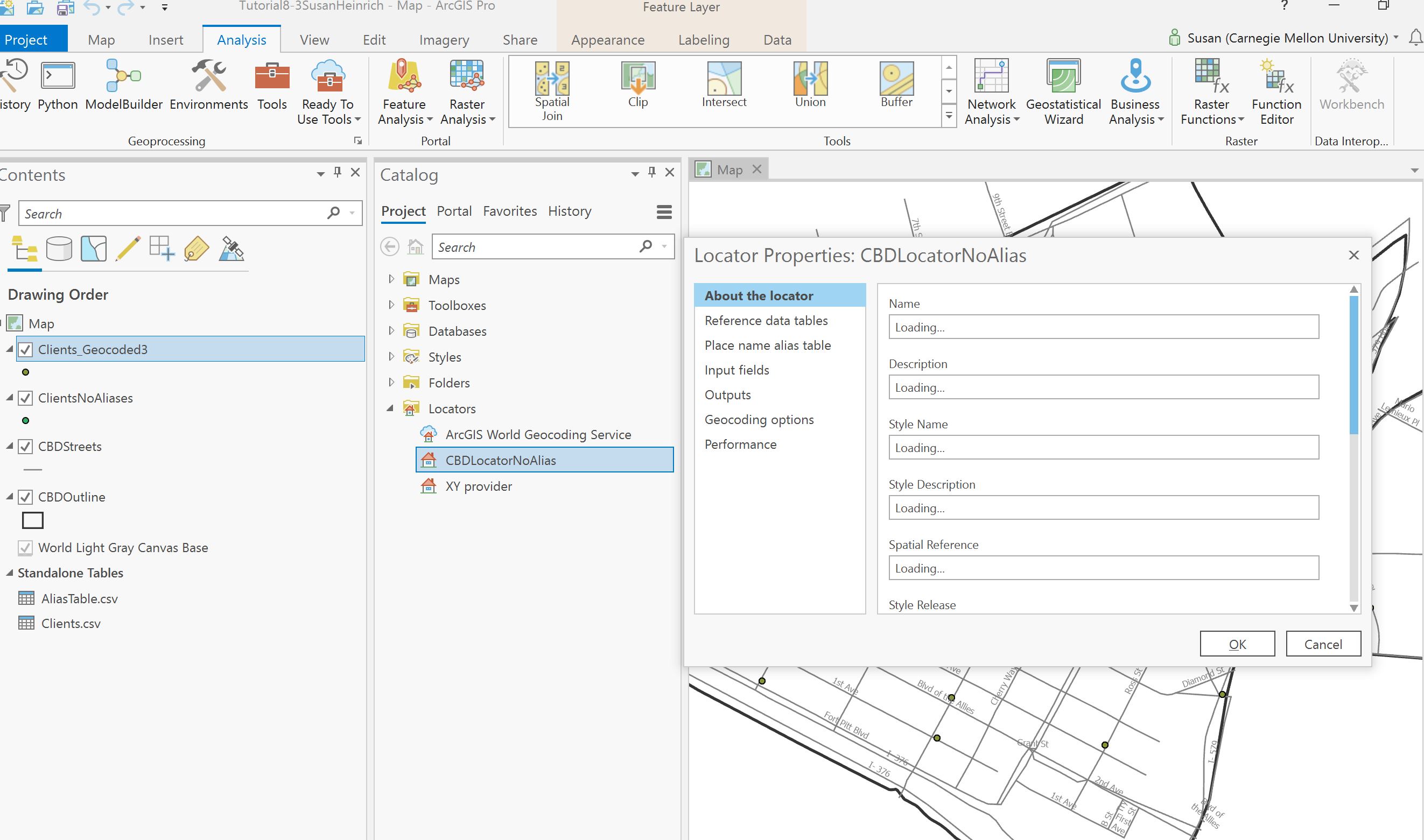

Hi, when opening the Properties for a Locator none of the settings ever load or able to be modified. All I get are a "Loading..." dialog that never returns anything (see image).
Any suggestions on how to fix this would be appreciated.
Locator Properties settings

1. Did you rename the locator outside of ArcGIS Pro after you created it, but before opening the locator properties?
2. Can you share a screenshot of the Catalog pane and Locate pane Settings tab that includes the locator where the properties aren't loading?
3. Is this behavior happening with all locators or specific locators?
SusanHeinrich
Hi Shana,
No, I have not renames the locator outside of ArcGIS Pro. I am having the same problem with all locators as far as I can tell. See image below.
Thanks again for your help.
Susan

SusanHeinrich
Hi John,
I have created another user and I am having the same problem. I have also uninstalled and reinstalled the software and have completed all of the updates... and I still have the same problem.
