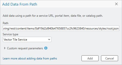

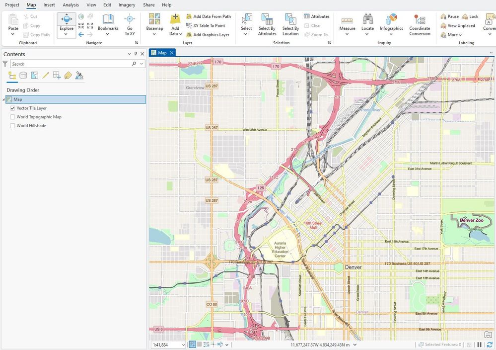

Thank you for the link!  So in my ArcGIS Pro, the Vector Tile Service works as expected - see attached.  To add this service, I went to the Map tab and in the Layer group, clicked the drop down for the Add Data button and clicked From Path...  In the UI for Add Data from Path, I copied and pasted the URL provided to me - https://cdn.arcgis.com/sharing/rest/content/items/0df19d2d940b47658857cc2fc9623840/resources/styles/... -
and the layer drew as expected.  I'm using ArcGIS Pro 3.4.x

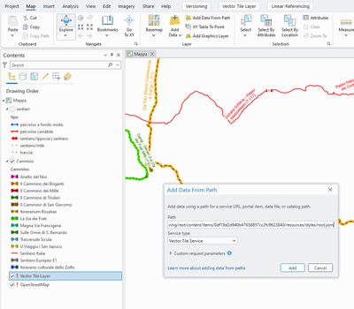

Unfortunately this workaround didn't work for me (I'm using the 3.4.1. just upgraded from the previous version with the same issue). The strange thing is that in my other ArcGIS PRO client everything works normally. As if there is a library or something else corrupted that is not being updated.
