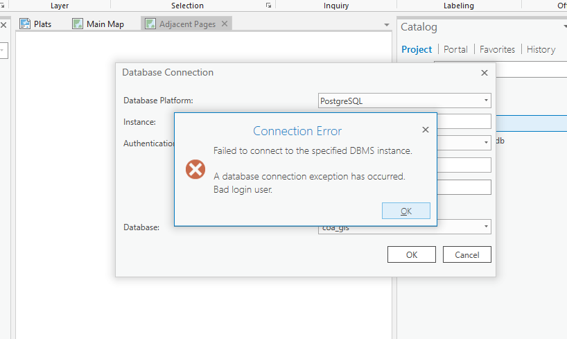

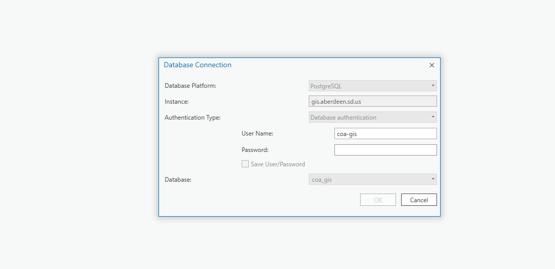

Hey all, I currently have PostgresSQL set up and was just wondering why Pro was not letting me connect with the pg-admin database. Wondering why this was happening. i've called ESRI tech support and told me that "The I will need to upgrade the database to version 9.6.3 (64 bit) in order to connect to the database in the current version of ArcGIS Pro (2.1.1). If upgrading to ArcMap 10.6, the database upgrade to 9.6.3 (64 bit) will also be necessary". i know what this means but have no idea how to go about upgrading it( or how to connect the Pg_admin DB into ArcPro).
how my database connection in Pro is set up
any advice? thanks

One question: In your screenshot you have the Instance name = gis.aberdeen.sd.us
Is this a machine on your local network or via the internet?
Can you sign into the PostgreSQL DB via PGAdmin from your local machine?

GeorgeJones
that is the instance of the server in pg_admin. Yes- i can sign into the local PostgreSQL DB on my machine.
