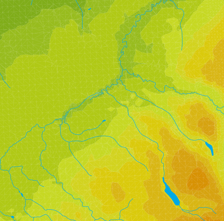

Hi. I'm trying to export a 2D map to a PDF file using ArcGIS Pro 2.2.4.
The map has a TIN surface, with colored elevation. When the PDF file is created (Share -> Export Map), I can see tiling and triangulated shading (See print-screen "pdf_export.png" attached), but if I just print the map to pdf using a pdf printer (in my case - Cute PDF writer), then there's no extra lines or shades, which is the desirable outcome (see print-screen pdf_print.png" attached).
Any thoughts on how to turn off the triangulated shades and lines when exporting to PDF?

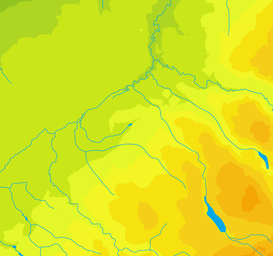

I was able to work around the white grid problem by converting a TIN surface to Raster. If I use raster instead of TIN, then the lines don't show up in the exported PDF files. The core issue seems to be in how ArcGIS Pro displays the TIN surface (I work with a 3D surface in this project)  - the "transparent" edges of the triangles show up in PDF as white lines.
E.g. below is print-screen of a PDF file with a raster surface instead of TIN surface.

Interesting. After I restarted ArcGIS, the pdf export was much better, and the shading disappeared (North-West of my map). However, the white lines (the grid) on the TIN surface still remain. Can't find the option to disable them.
