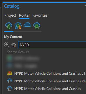

I believe that the "My Hosted Services" in ArcMap is listing all the hosted data within ArcGIS Online or ArcGIS Enterprise. You can access this when you use ArcGIS Pro and connect to your Enterprise or Online organization.
ArcCatalog:
ArcGIS Pro:
It just does not show all the "hosted" data separately.
Use ArcGIS Pro and ArcGIS Desktop with your portal—Portal for ArcGIS | Documentation for ArcGIS Ente...
Is there a specific reason that you need to see only "Hosted" data?
--- George T.

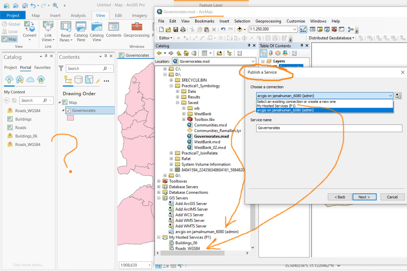

As we publish in ArcMap, we can choose either to publish on ArcGIS Server or ArcGIS Online as shown in the screenshot below. How this can be performed in the Pro?
Jamal Numan
George_Thompson
Esri Notable Contributor
I am not sure that you can do that, unless you have logged into your ArcGIS Online org via ArcGIS Pro and have a connection to an unfederated server.
