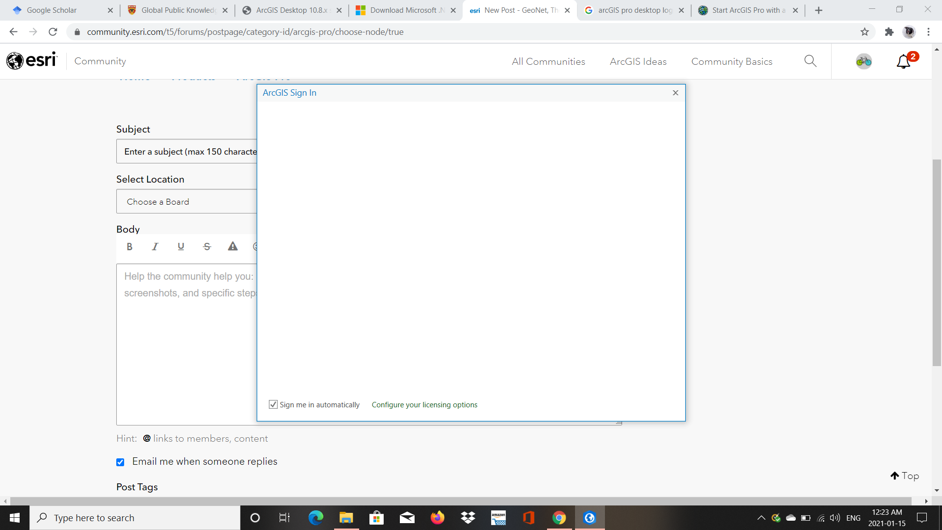

I have downloaded ArcGIS Pro for desktop following my university instructions to the T using my  named license, however when I try to run the program it opens to a frozen grey screen. Occasionally when I play around with it it will take me to the login screen where I would put my account information, however it will not let me type anything.
I have a brand new computer that meets the requirements of the operating system, and I have even used the ESRI check system software to verify that I do in fact meet the OS system requirements. I have completely deleted the program and re-installed it, and changed the names of the downloaded files to ESRI_old as suggested in some of the help forums on the ESRI website, all with no change in luck. If anyone else has had this issue I would LOVE help. It stays on this grey window unless I go to configure licenses, and then hit back, to which the login screen appears, and I cannot type anything.

At the bottom of the blank ArcGIS Sign-In User Interface, click "configure your licensing options" and choose "concurrent license type" for your License Type.  Although you don't have a concurrent license, it will "disconnect" as it were from the Named User Login screen and then fail to connect to a License Manager.  Then change the license type back to "Named User License", click OK, and see if the login screen is visible.
Another thing to try is move your mouse to where the Username box "should" be, click and type in your username.  Then Tab to the Password "blank area" and enter your password.  Then click the Enter key on your keyboard.  Does that work?
Next is to temporarily disable your firewall and see if you can log into ArcGIS Pro.  Then if successful, you'll need to talk with your IT staff to whitelist the application.

A small update regarding this issue:
Starting at version 2.6, ArcGIS Pro no longer uses Internet Explorer but instead uses Chromium for it's web interfaces. Therefore, any suggestions above regarding Internet Explorer no longer apply.
There are however, issues with Chromium components getting blocked on enterprise computers (e.g. at school or work), or with hardware acceleration.
Esri is aware of these issue and is working on solutions. In the meantime its highly suggested that anyone still experiencing this reach out to technical support directly.
You may find some solutions at: https://support.esri.com/en/Technical-Article/000025347
