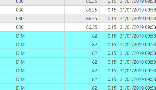

Hi guys,
I am pretty familiar with Field Calculator in ArcMap and PRO.
I've learned that the field calculator calculates values only for selected features. Not today.
I wanted the 0.15 value only for the 13 selected features. All my 1200 features now have 0.15.
Is there any option to disable this that I might have chosen by mistake?
Thanks.

The issue was found to be caused by duplicate layer names in Contents, and the Calculate Field tool used the duplicate layer that didn't have a selection rather than the duplicate layer that had the selection. Can you confirm if you have multiple layers with the same name?

Maybe I found the reason:
I have the same layer in 2 different maps.
I might have opened the 2 tables form both maps and opened the field calculator from the one with no selection by mistake.
Something to pay attention to for the future, since in PRO all maps are virtually active.
