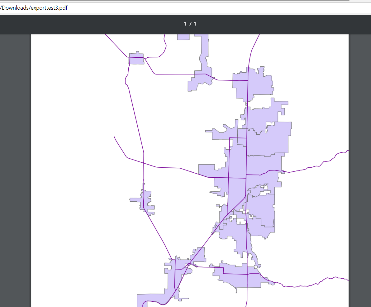

I can see some of the pdf in Chrome but I get the same message trying to open in Acrobat

LR
The file is not PDF/A compliant, that's why it won't open in Reader.
Fileexporttest3.pdf
Compliancepdf1.7
ResultDocument does not conform to PDF/A.
Details
Validating file "exporttest3.pdf" for conformance level pdf1.7
XML line 11:3: error parsing attribute name.
XML line 11:3: attributes construct error.
XML line 11:3: Couldn't find end of Start Tag Description line 9.
XML line 15:19: Opening and ending tag mismatch: RDF line 3 and Description.
XML line 42:16: Opening and ending tag mismatch: Alt line 40 and Bag.
XML line 48:34: Opening and ending tag mismatch: PDFVersion line 48 and Keywords.
XML line 52:11: Opening and ending tag mismatch: xmpmeta line 2 and RDF.
XML line 53:1: Extra content at the end of the document.
The document does not conform to the requested standard.
The document's meta data is either missing or inconsistent or corrupt.
The document does not conform to the PDF 1.7 standard.
Done.
