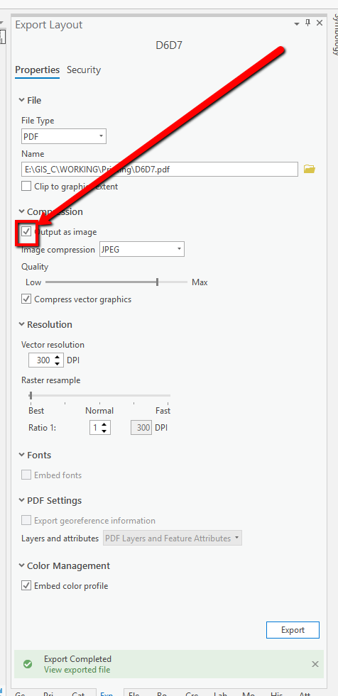

RenRosin
Hi Lara,
I did some more digging, and discovered if the box "Output as and image" is unchecked it worked ... checked it gave me the same error.
Maybe that's the answer!
