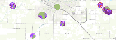

I have a raster file that I clipped to a 5oom buffer - see picture. In each clip the are multiple land uses. I would like the dominant land use in each clip for each zone in a table. I have used Tabulate Area tool but that just gives each land use area for each clip and I only want the dominant land use in the buffer area.

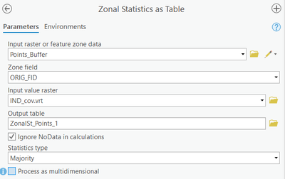

Zonal Statistics as Table should work. Choose "MAJORITY" as the statistics type.

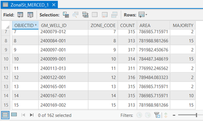

Here is what I get executing Zonal Statistics as Table on your dataset.
Think Location
Hope-Hauptman
This did finally work - thank you so much. One more quick thing - is it possible to know not just the majority category but the area of that majority (the sum of the area in the majority of a circle/buffer)?

Thanks again. I did try but the output table only has one line with the majority identified. And the area is the area of the buffer (circle 500m radius) not the area of the majority. Regardless it is only for one ORIG_FID see screenshot. I really appreciate your help.
