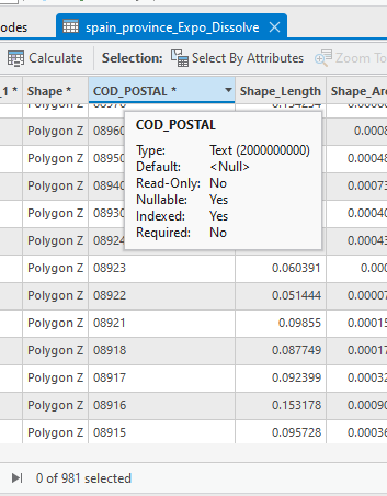

This is the result of the analysis - 981 records:

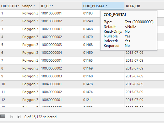

and the original:

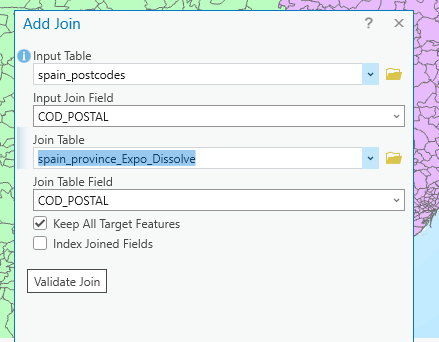

I'm adding the join:

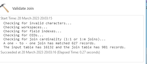

but for some reason the join doesn't find all the values:
I checked and there are no selections or filters on any of the layers and despite the "0" at the beginning of some of those 981 postcodes, the field type is definitely Text.
Am I missing a step or two to make this join?

I trimmed both fields but no effect. Mostly because the postcode in the layer comes from source anyway:
