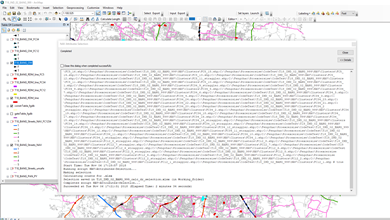

This toolbox can run successfully with flexible numbers of input shapefiles in ArcMap 10.5 or ArcMap 10.6, no matter how many the input layers are.

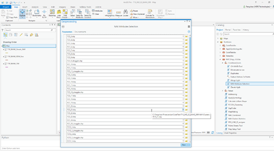

The toolbox can run successfully with less flexible number of input shapefiles (from 1 to 20) in ArcGIS Pro 2.2.
However, when the number of input shapefiles is increased to 56, it crashes and I get the error “ArcGIS Pro has encountered a serious application error and is unable to continue”.

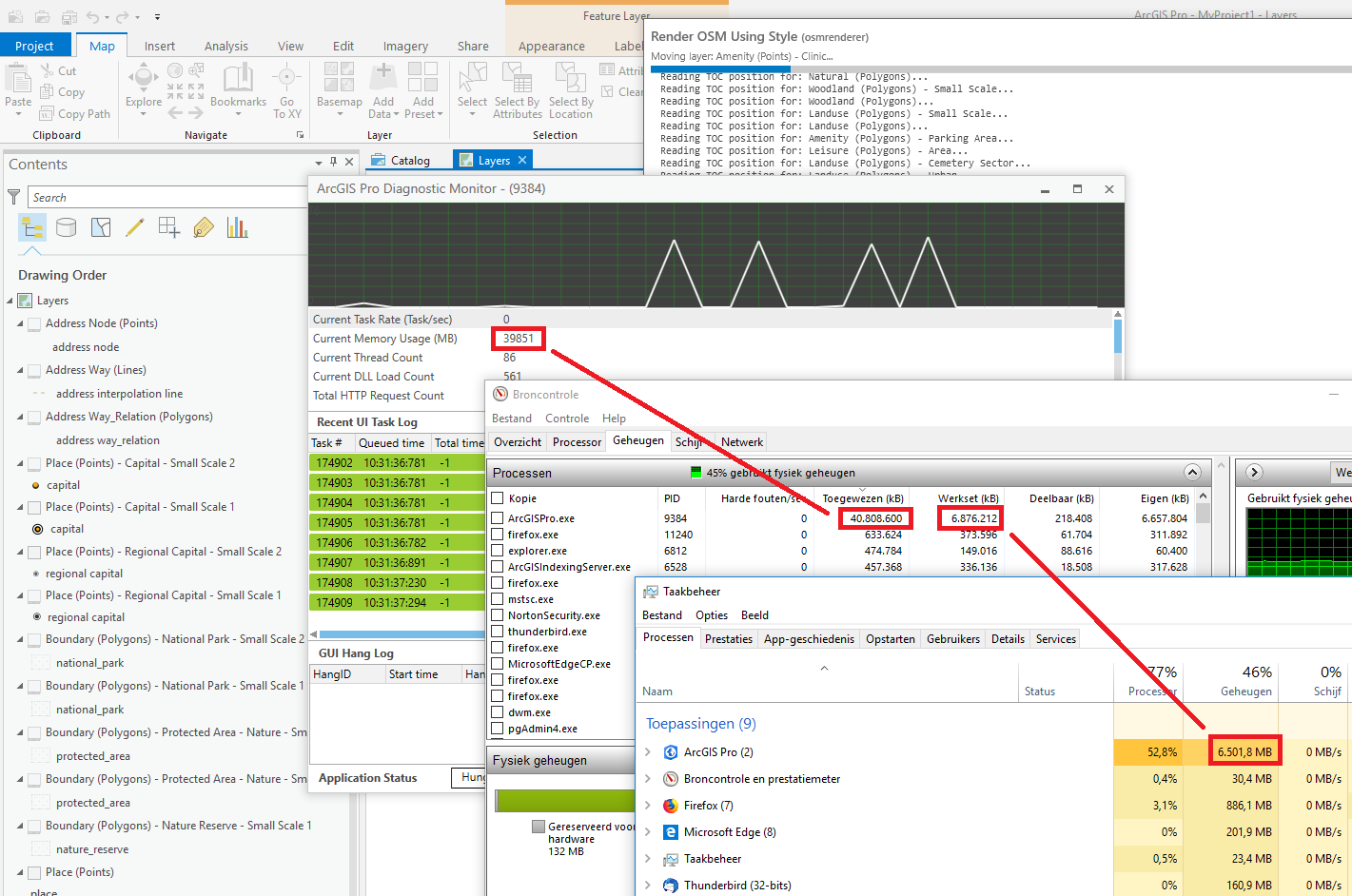

Most frustratingly, sometimes it worked, other times it didn't. Stupidly enough, I only watched Pro's RAM usage in the Task Manager, which never went past let's say 8 GB max (my laptop had 16 GB) and which only shows the memory used for an app actually residing in the physical RAM... hence I never really suspected memory issues... until I finally opened up Source Control from the Task Manager, and discovered Pro was allocating >40(!) GB of memory , almost all of this being stored in Windows virtual memory / swap space, and only a fraction in actual RAM! See the attached image showing only 6,5 GB of allocated memory actually residing in the physical RAM, but >40 GB memory in total allocated for Pro only.
This means Pro needs about 75-100 MB for each and every layer it handles in the TOC. This is dramatically more than ArcMap, which can handle the same amount of layers in just 2 GB being a 32 bit app.

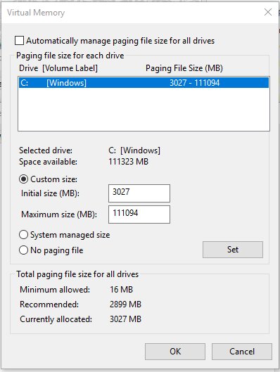

As a consequence of this realization, I not only bought another 16 GB of RAM for my laptop, but also raised my Windows 10 virtual memory setting to a staggering 80 GB.
Since the past two weeks I implemented these changes, all of the crashes have melted away like ice in the desert sun. No more crashes...!!!
I seriously have had only one predictable crash since raising the virtual memory to 80GB and raising RAM to 32 GB (so 112 GB of allocatable memory in total), and that was when I deliberately pushed Pro to consume even that gigantic amount of available virtual memory / swap space by opening three concurrent sessions and setting them to work. Eventually, just one instance of Pro crashed when hitting the 112 GB limit, the other two stayed stable and usuable after the crash of the other instance.
I therefor strongly recommend you to set at least 50-100 GB of virtual memory in Windows to avoid crashes when processing dozens or hundreds of layers in Pro. It should alleviate your crash issues considerably, if not make them disappear completely, as it did in my case. Pro has been nothing but rock stable since then.

I have tried to increase the size of virtual memory to 100GB. But unfortunately, I still get the same crash error. So it seems that because of the script itself.

Thanks for the response, but before jumping to the conclusion that this is "the script itself", could you please re-run the script with the same virtual memory settings, but this time actually monitor the Pro allocated memory by either using the ArcGIS Pro Diagnostic Monitor (Use keyboard shortcut Ctrl+Alt+M to open it in a running ArcGIS Pro project), or open the Windows Task Manager's Resource Monitor option (it is on the second Performance TAB of the dialog of the Task Manager).
Unless you've truly verified that you do not hit the 111GB alllocatable memory limit you have now set, there is no real garantuee this isn't still a memory issue.
Honestly, the highest memory usage I have seen up to now was 64+ GB (see post somewhere down below in this thread)! Especially if you have a second session and some other apps open consuming memory as well, you may still be hitting the same wall...
