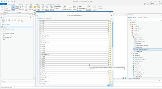

I have one feedback about ArcGIS Pro 2.2. It crashes every time when I run a toolbox with increased number of shapefiles (around 56) as input parameters.  The toolbox is created by our team and below is the detailed description.
The function of this toolbox:
Get the input parameters and make attributes selection.
Main arcpy functions:
input = arcpy.GetParameterAsText()
arcpy.SelectLayerByAttribute_management()
Result:

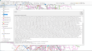

This toolbox can run successfully with flexible numbers of input shapefiles in ArcMap 10.5 or ArcMap 10.6, no matter how many the input layers are.

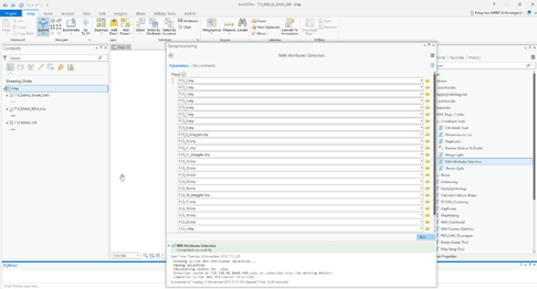

The toolbox can run successfully with less flexible number of input shapefiles (from 1 to 20) in ArcGIS Pro 2.2.
However, when the number of input shapefiles is increased to 56, it crashes and I get the error “ArcGIS Pro has encountered a serious application error and is unable to continue”.

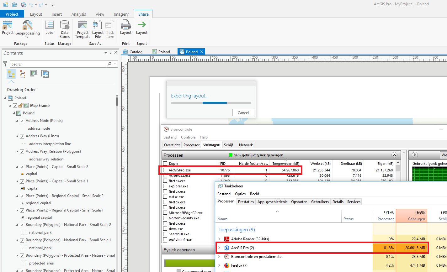

And here is another nice screenshot, a single session of Pro consuming > 64 GB(!) of memory during the export of a complex topographic map layout to PDF format using many layers in the map document, 20 GB in RAM. With my old setup, Pro would have fatally crashed well before reaching this point. Not so now! This is actually the highest value I have seen up to now for a single session.
Please note that if you never use more than say two to three dozen layers in Pro on a regular daily basis, you will never see Pro consuming this much memory!

Are you running the toolbox as a batch? Your py shows 1 input for feature class, yet your screenshot shows many.
