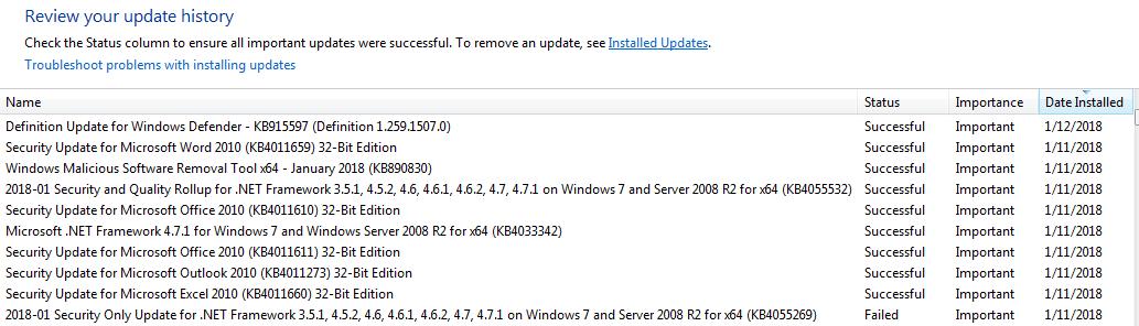

This morning I awoke to several users saying that ArcGIS Pro will not open.   It crashes immediately at the "Initializing..." point of the splash screen.   Windows update ran on all 3 machines last night, see those updates below.
I have confirmed on a machine that did not receive these updates that ArcGIS Pro is still running correctly, so I would assume that rules out any issues with our License Manager.
Has anyone else experienced this today?

Analysis of the crash dump generated shows the crash is indeed WPF related and is a TypeInitializationException as Microsoft's makes in their statement.
