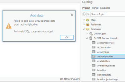

@KieranClark :  I followed your advice as well as post from  @KenGalliher1  and I've established a MySQL connection through ArcGIS Pro (2.7.1) but I get an error when I try to add a table to my ArcGIS Pro session:
I can get to this data base (which is web hosted) using WorkBench without any problem.
Any ideas?

If anyone is still following this post or comes across it, the problem I describe is now a listed as a bug when connecting to MySql ver8.
BUG-000141014
