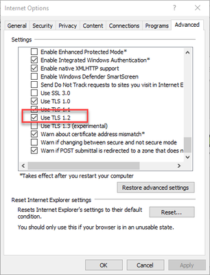

I actually find the solution somewhere else and since the original solution link expired. I will put some quick steps for whoever might need this:
This most likely a windows machine only problem and you will need to go the IE browser (no edge, chrome, or firefox) --> Tools --> Internet Options --> Advanced --> Scroll down to the check the Use TLS 1.2 option --> restart the ArcGIS Pro

Another solution is click button 'Reset' in tab Advanced. In a computer with checked 'Use tls 1.2' there was same problem but with reset now it's OK.
BryceBeyers
Any idea why my Internet Options doesn't give me the Reset option? I have the Restore advanced settings but don't have that bottom portion at all
