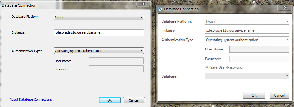

I'm using Beta 4, Build 1141.  I copied the instance 'string' from ArcCatalog 10.2.0 to the instance string input box in ArcGIS Pro. The ArcCatalog connection dialog box is on the left and the AGP dialog box is on the right.  They are identical
I have no problem connecting to and editing this SDE database via ArcMap, which strongly suggests that the Oracle client libraries are properly installed on my computer.    But I get the following error from AGP when I click 'OK'
Connection Error
Failed to connect to the specified server.
A database connection exception has occurred.
Cannot connect to database because the database client software failed to load.  Be sure the database client software is installed and configured correctly.
OK
Any ideas what's going on or how I can correct this problem?  I realize that this is a beta version......
