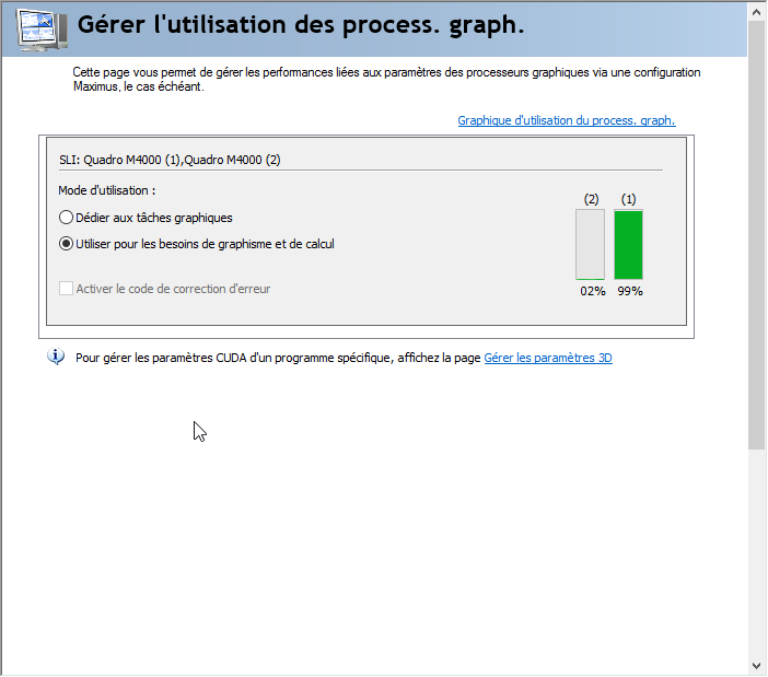

Do you know if there is a way to use ArcGIS Pro with two graphic cards using SLI ?
I have two nvidia Quadro M4000 working together with SLI but when I render a 3D scene video in ArcGIS, only one card seems to be used.
With 3D software Blender I can choose whether I render with CPU or GPU, and in GPU mode I can see both card being used.
Here while rendering with AGPro :

ArcGIS Pro tool reference—ArcGIS Pro | ArcGIS Desktop
is the only reference that I could find about nvidia settings.  It seems setting 1 for display and 1 form processing is recommended.  It is accessed through a tool's Environment settings way at the bottom
