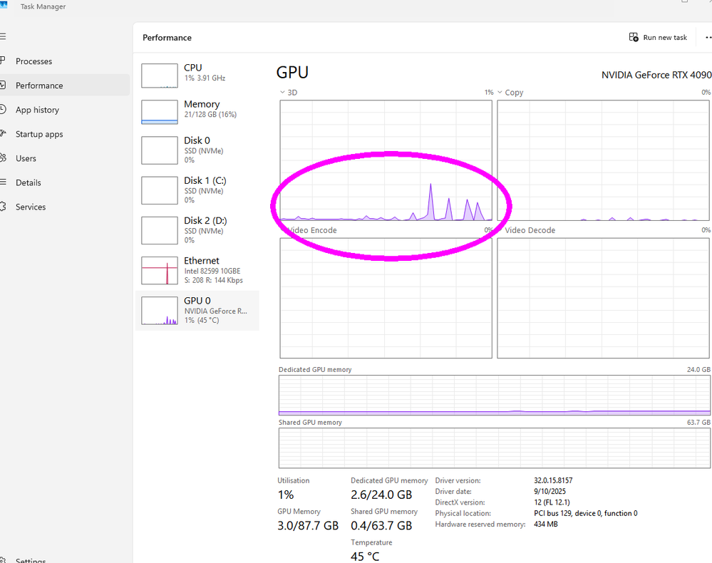

Open the Windows Task Manager, go to Performance, and select the GPU tab.
Depending on your monitor size it may help to pin Task manager to the top (overlaying Pro so you can see it all the time).
Keep an eye on it and see if it crashes as soon as Pro creates a little peak in the GPU usage.
These blips are from doing some basic colours on the states of Australia.
Something more complex may create a bit more greenhouse gasses 🙂

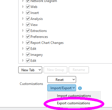

Then, under "Options >  Customize the Ribbon"  you can export your current Ribbon and Quick Access Toolbar configs.
The fun part is that the config file is just an XML file so you can use something like XMLNotepad to tweak a few things.  I used it to split my config into QAT & Custom Ribbon objects to troubleshoot something else by selectively importing parts of my config.
