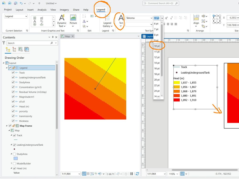

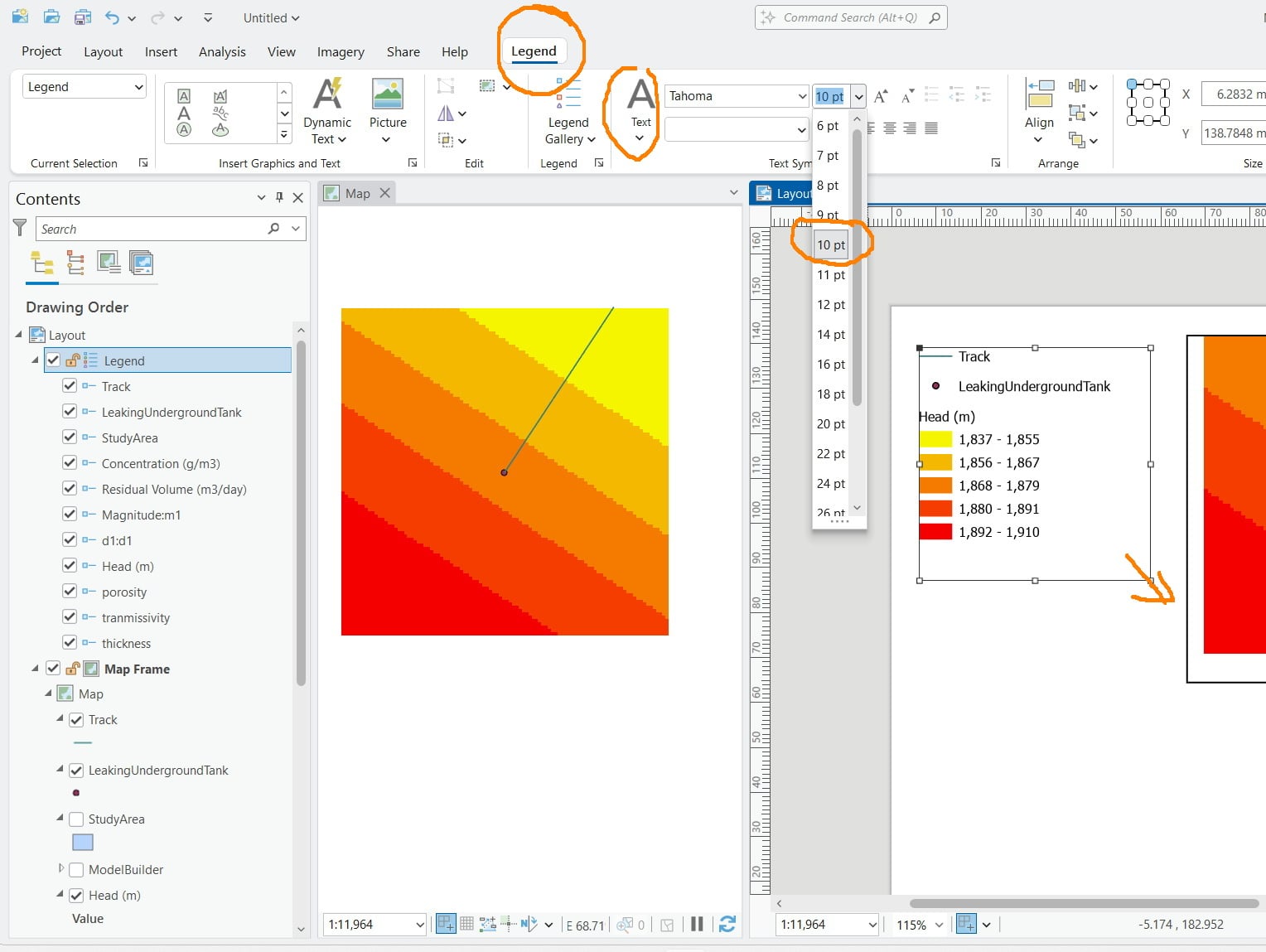

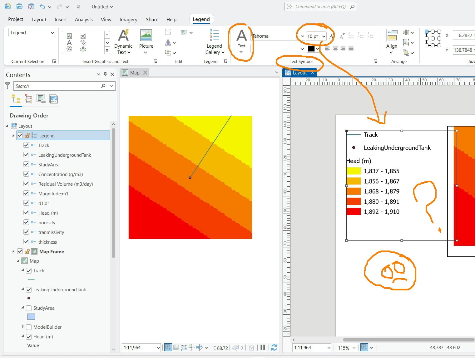

For example, in the screenshot below, the initial font size of the text within the legend was set to 10 pt. After resizing the legend, the displayed text size physically increased, but the numerical font size in the ribbon remained unchanged.
How can the ribbon reflect dynamic changes in font size, such that resizing the legend also updates the displayed font size value accordingly?

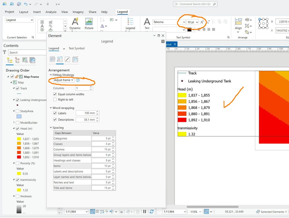

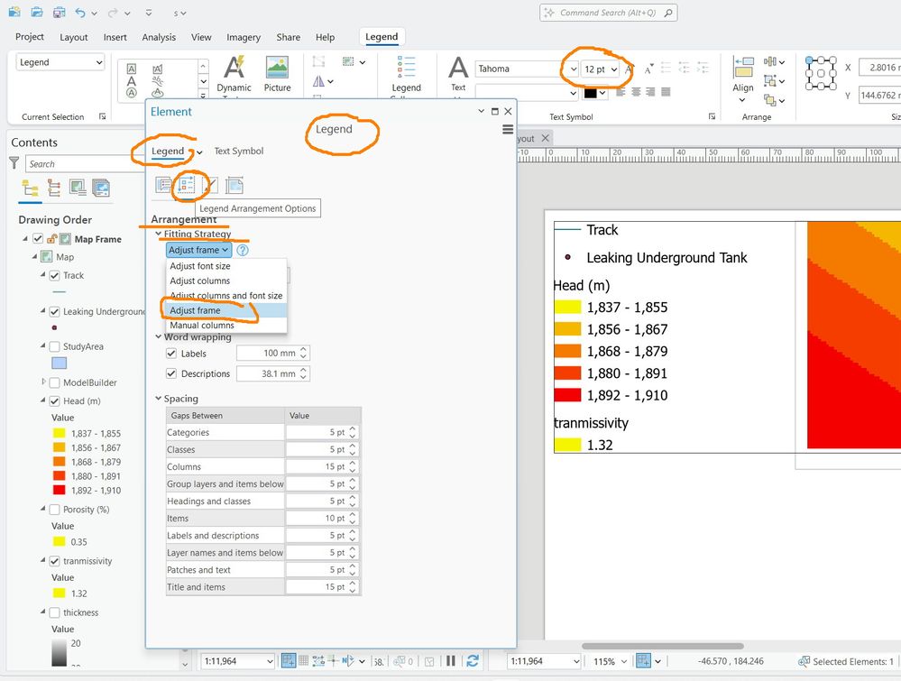

Hi Jamal
Do take a look at the Legend fitting strategies. Legend fitting strategies—ArcGIS Pro | Documentation
Right click on Legend > Properties > Legend Arrangement Options to access it. The two you need to try are Adjust Frame or Adjust font size.   Adjust frame will limit the size of your legend based on the font size provided. Adjust font size will change the font size based on the size of the legend frame.

JamalNUMAN
Legendary Contributor
Thank you for the help. It works fine
