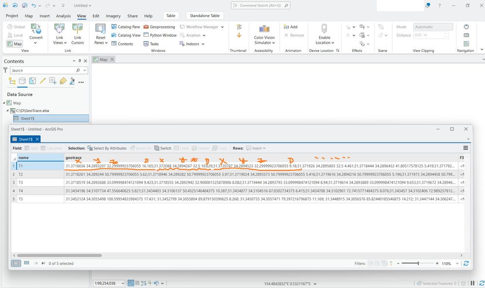

For example, in the screenshot below, the geotrace field contains the XYZD values (latitude, longitude, altitude, and precision) of multiple points in one cell. How can these points be mapped?
A sample dataset is attached in an Excel file.

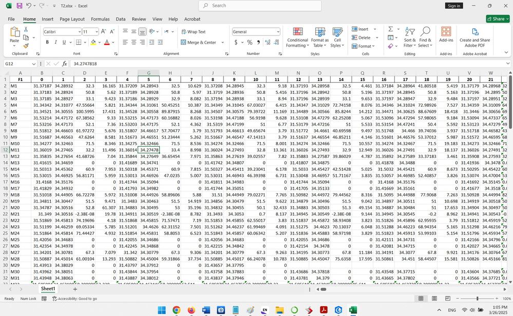

Looking at the table, each coordinate pair is separated by a semicolon so that is the first split. Take each of those and split again on the space delimiter to end up with coordinate pairs. From there you can build your points or lines. You can see the results of this in the attached edited Excel file.

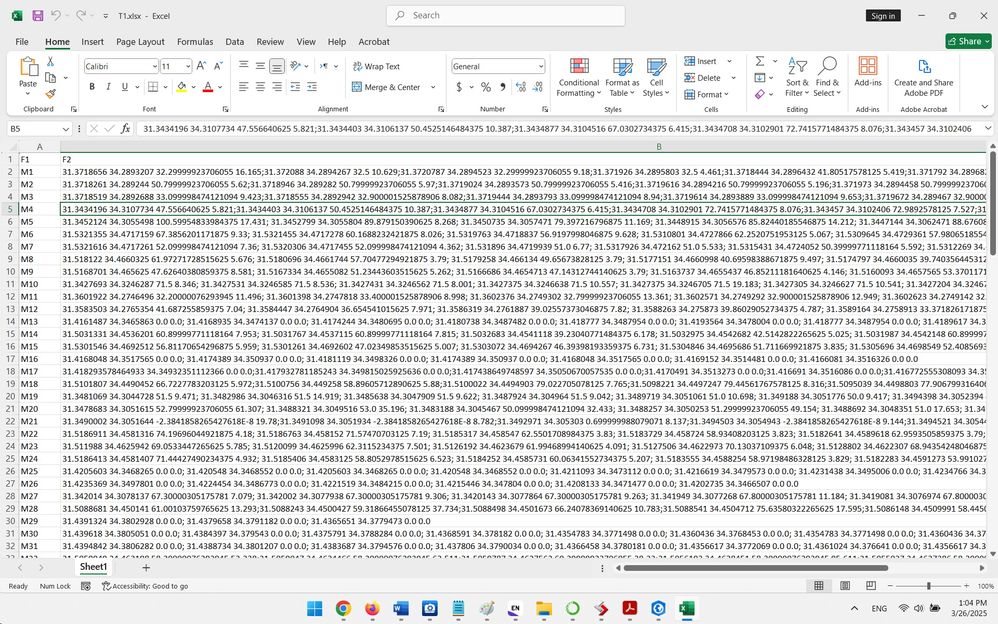

Write a Python code to read the data from the table below
"C:\D\T1.xlsx"
Then do the following
  • Go to the second column with the name F2, for each record, divides its values (separated by space, semicolons, or whatever) into separate columns in separate columns, then, save the result in a new table in C:\D (Name it T2)

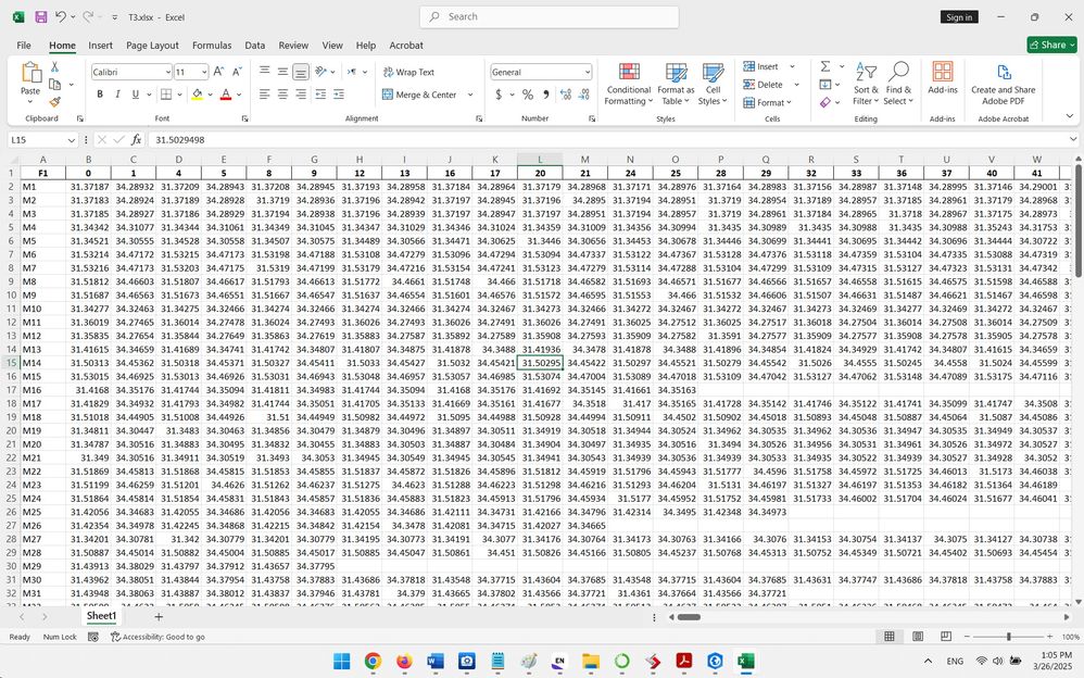

  • For the T2, skip the first column, then keep the first two columns, delete the next two, keep the next two, then delete the next two… repeat this pattern for all columns in T2. Save the result in T3
  • Now, for each row in T3, stick the values of the first column and the second column in a new record, then again stick the values of the third and the fourth column in a new record, then again stick the values of the fifth and sixth column in a new record and so forth. Save it in T4
