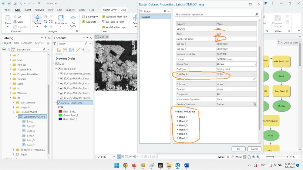

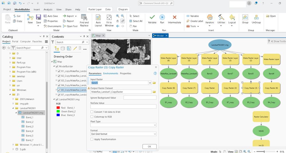

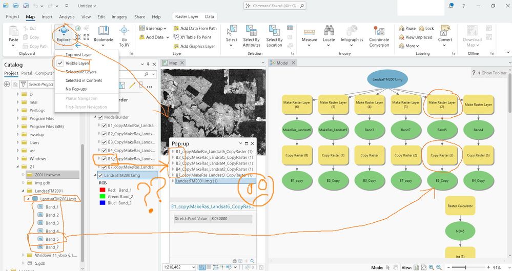

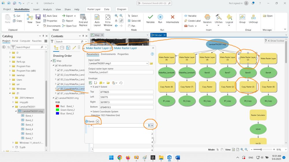

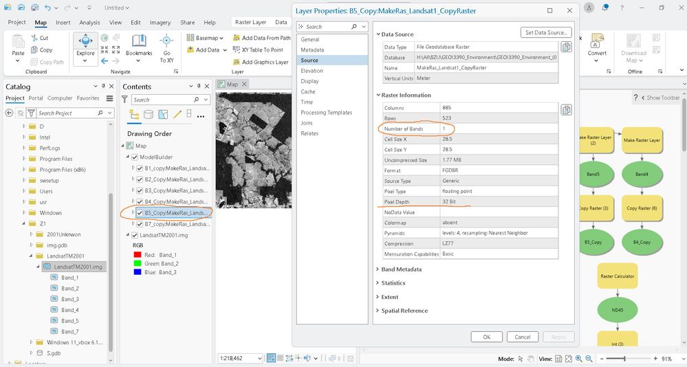

In the screenshots below, I couldn’t figure out why the pop-up fails to return values for the cells of band 5 obtained from a six-band imagery. Band 5 was obtained using the “make raster layer” and “copy raster” tools. This happens even though the pop-up is able to return values for all other bands extracted using the same technique.
What could be the issue here?
The imagery is attached

@JamalNUMAN I'd pull in the landsat B5 layer and see if it draws and populates on it's own. If the popup works for it, then something in your workflow isn't working correctly if I had to guess.

You are right. I recreated everything from scratch—aprx, atbx, model, scratch workspace gdb, etc.—and found that everything appears to be working as expected
