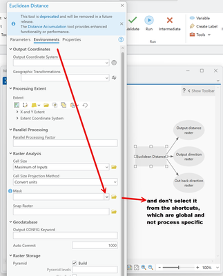

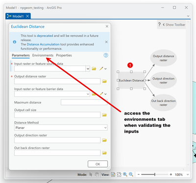

It is the use of shortcuts I suspect.
when validating the inputs to the tool, select the environments tab there and not after the fact.
A drop down will appear since the tool validation is aware of the possible inputs as it is being used.
When things are done after the fact, via a shortcut, you can still set the environment, but you have to select it after from the file on disk.
making shortcuts behave as the expected process adds a whole extra layer of unnecessary checking.
To access the drop down within environments simply keep within the modelbuilder tool settings and not those of the shortcuts.

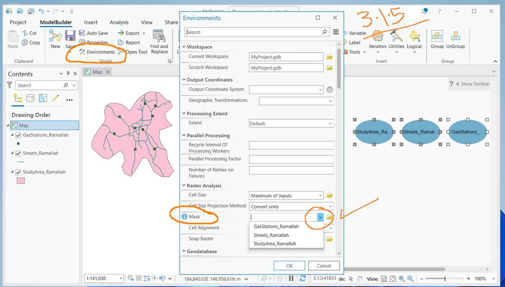

Two things:
  • This feature used to be available in previous versions of Pro. A screenshot is provided for Pro 3.1.5, where the dropdown menu selection is available. This is most likely a bug in Pro 3.4.2
  • Setting the “environment” at the model level is much more efficient than setting it for each individual tool.
