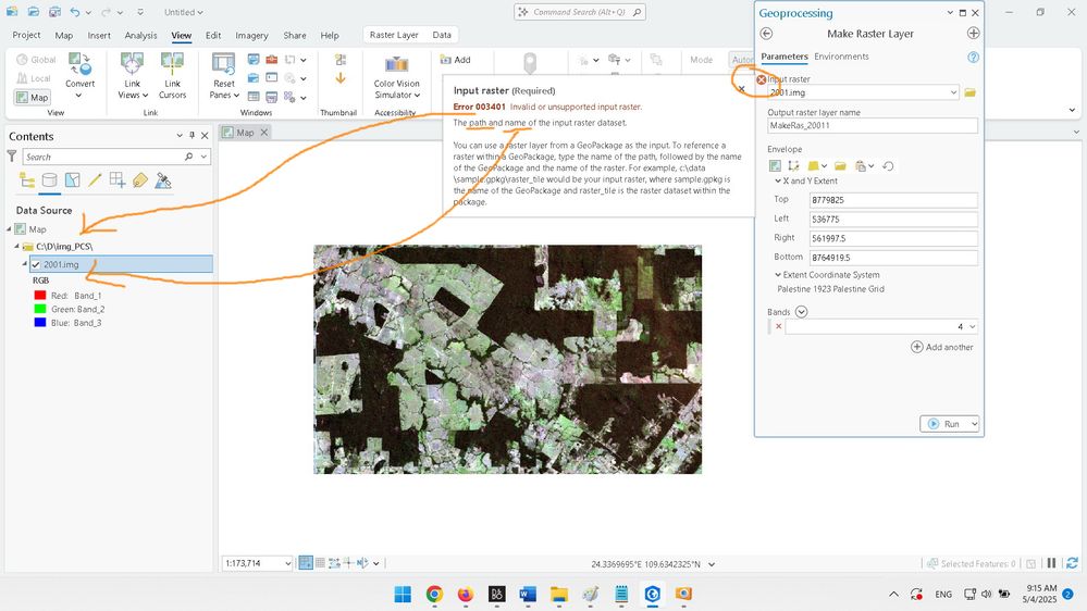

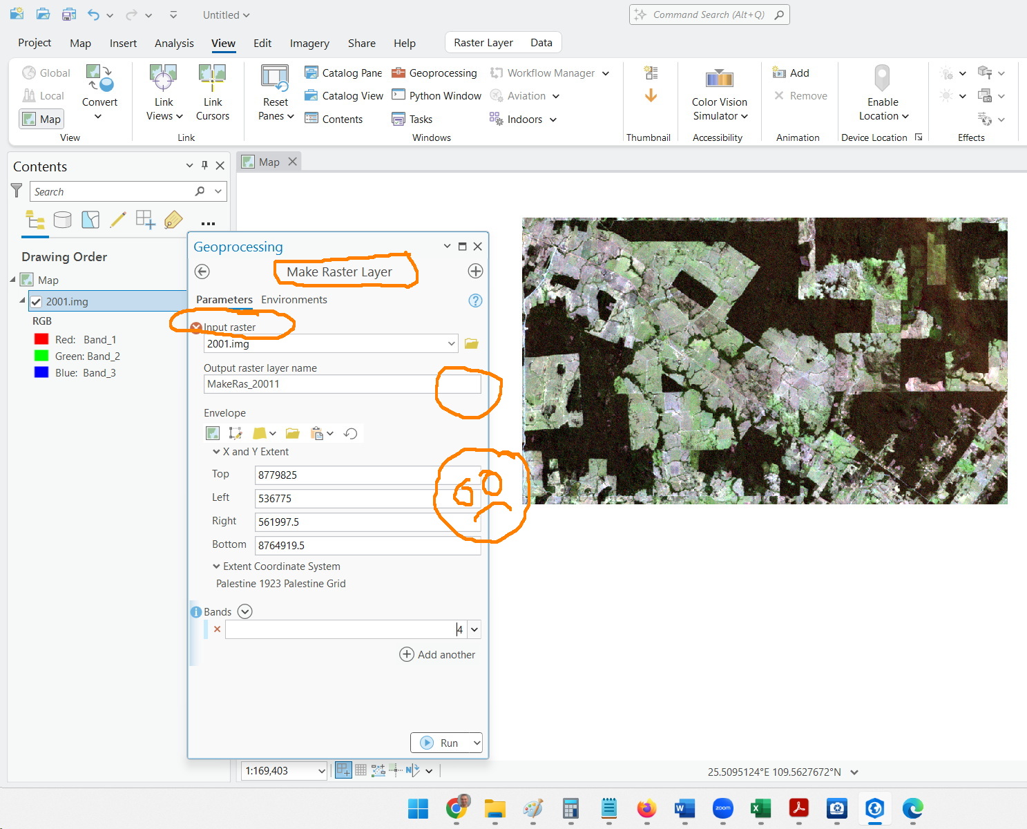

In the screenshot below, the “Make Raster Layer” tool does not seem to provide a browse option for defining the output location.
What could be the issue here?

because it is a layer for the map and it is temporary
Make Raster Layer (Data Management)—ArcGIS Pro | Documentation
you can make a *.lyrx file using
Save To Layer File (Data Management)—ArcGIS Pro | Documentation

Hi Dan,
Then what could be the reason behind the error shown in the screenshot below? What’s wrong with the path and name? They should be okay.

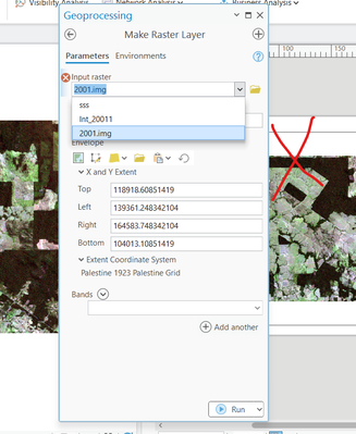

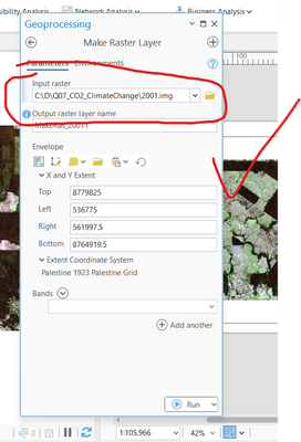

HamedHadad
you have to put the entire path to the image for this tool or it won't recognize it, try clicking on the input raster, if no path was written go to browse and locate the image with its path
