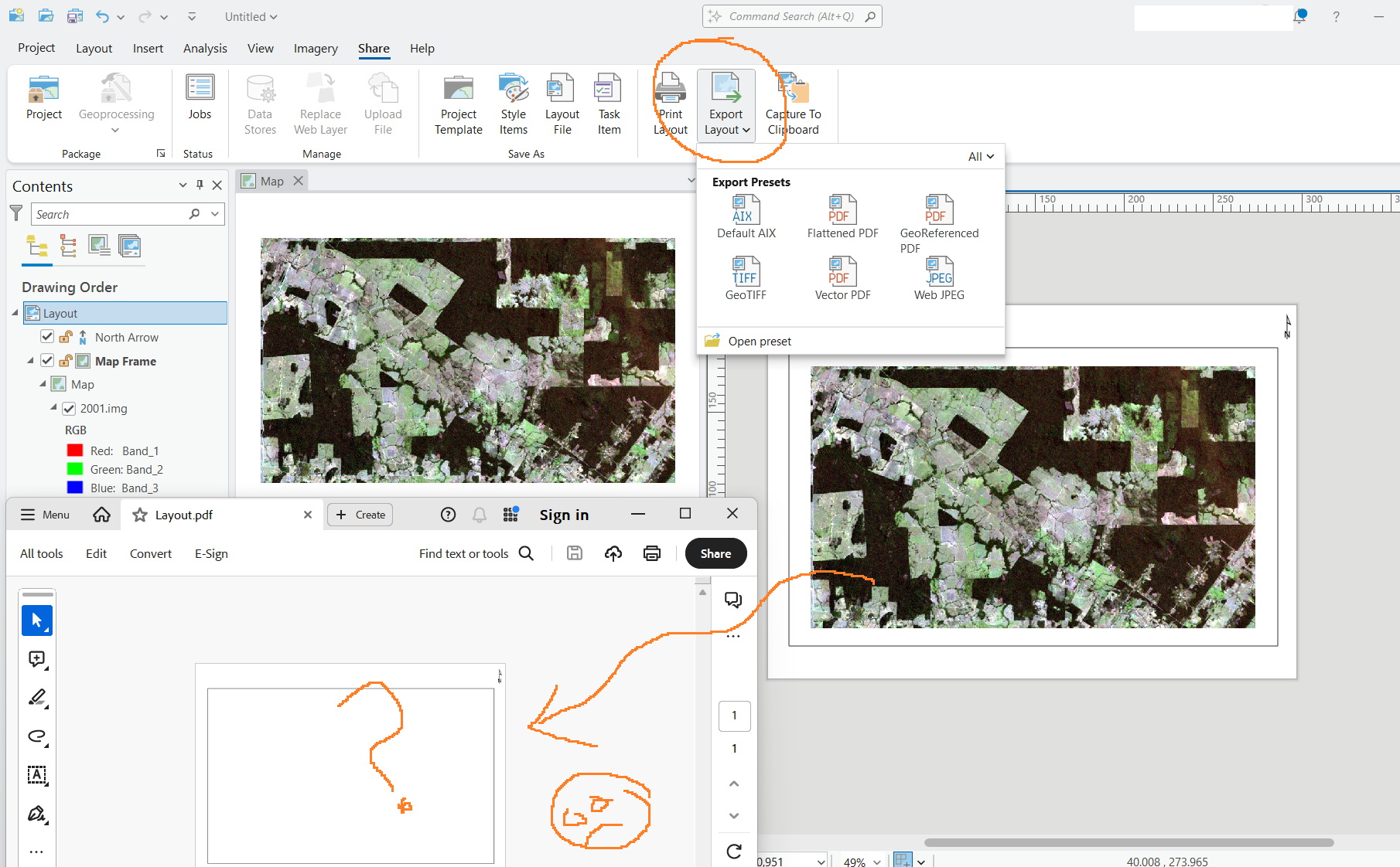

In the screenshot below, I exported a layout containing imagery as a PDF. The PDF was successfully generated; however, the imagery is missing from the output.
What could be causing this issue?

the image you shared is the same corrupted one that was outside of the coordination system
i tried exporting the georeferenced one and it worked just fine
its kind of weird that all these issues are caused from coordination system corruption even tho its not connected.

Setting the coordinate system of the imagery to be “unknown” appears to resolve the issue where the layout is exported successfully
