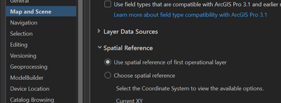

I exported from the layout using the panes Share -> Export.  By the environment setting I assume you mean here:
Toggling that makes no difference for me either, ArcPro still doesn't recognize the coordinate system.  Is there a setting somewhere I'm missing?

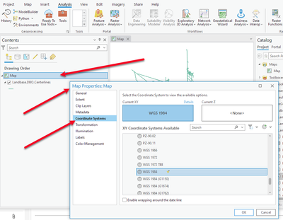

However, if you set the coordinate system for the Map:
Then export the GeoTIFF, it will then be in the coordinate system of the Map and will be detected by map/pro.

Yep, that's exactly how I'm setting it in the Map Properties and getting the unknown coordinate system for the output.
