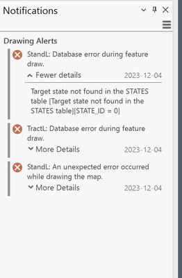

  I've upgraded to ArcGIS Pro 3.2 and found when editing a Versioned Geodatabase located within SDE that I'm now getting this error now:
  Seems researching it, I'm just finding some information that it could be linked to a corruption of the database somehow or at least something with the linking of the table via SDE.
  We've run some maintenance scripts as well as I've relinked the entire table as I have noticed that in 3.2 the New Database Connection has  changed it's look a little from 2.9.
  I'm notcing this is happening with several different tools, not just one.  Such as creating a new feature, reshapping, etc.  So I'm not thinking it's directly related to Editing of the Versioned Geodatabase on SDE.
  Any suggestions that I or the database side GIS guys can look at to try and resolve this issue?
  I'm assuming it's from 3.2, but not 100% sure as I haven't worked in this database for a little over 2 weeks, but I did notice it after updating to 3.2 at least...
Thanks

Hello, my organization is experiencing the same error. However, we do have sql server 19 and our geodatabase is at version 11.1. We have ran the diagnose version tables and metadata tables and no errors are reported, however the error message regarding state_id=0 in ArcGIS Pro 3.2 persists. We dont have any other versions aside from default. Any recommendations on how we might fix this?

Here to say we're having the same issues. I just looked and we're on SQL Server 2016 for our enterprise database. I'm not encountering these errors super frequently, but I do far less editing than the staff that is running into it. We recently upgraded our ArcPro to 3.2x after which an uptick in the drawing alerts calling referring to target STATE in the database tables. The bug specifically refers to clicking 'cancel' or 'no' to saving, but that's not we're doing here to get error, mostly just editing anything at all and saving.
This is also not just polyline editing but  point editing for us too.

 @TanuHoque  In our case, once we got "Drawing error" , geometry was disappearing. now we do believe we have compatible  geodatabase and versioned table that worked for decades
-so what is the "hidden away" issue ?
-was there mandatory geodatabase upgrade to 11.2 ?
- it's simple ,  it worked fine 2.x, 3.1  and suddenly broken in 3.2.  without clear reason
- i will create support ticket but we need clear guideline on this , as i suspect other will experience same issues

Same in my case, the geometry completely disappears after the error. Although these drawing errors being displayed are supposed to be a feature of 3.2, I find it fishy that this specific error is happening to others all while nothing appears to be wrong with our databases according to ESRIs own diagnostic tools (diagnose version metadata and diagnose version tables). ArcGIS Pro 3.2 introduced discarding and undoing edits on non-versioned data which makes me wonder if there was a bug introduced. Currently, this issue isn't documented as a bug, and when we opened up a support ticket, support seems hesitant to do so because they can't recreate the issue. Altogether, I think either there is truly something wrong with our databases that the diagnostic tools currently don't catch and we have been fortunate enough to not to receive this error in every previous version of ArcGIS Pro or there is some issue with ArcGIS pro 3.2, which seems more likely to me. As of now, I will probably just revert back to ArcGIS pro 3.1.
