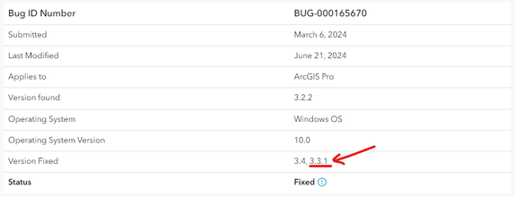

I was hoping the same Andrew, but in BUG-000165670 it was updated to say FIXED and that the issue is addressed in version 3.4! Considering 3.3 just released today, who knows when that release will be..

Just noted this morning BUG-000165670 and BUG-000163841 now included the issues are addressed in version 3.4 and 3.3.1.  Appears ESRI is planning an additional patch release before 3.4.

This is extremely exciting news! Sadly I will not be able to update my ArcPro due to other dependencies within my organization. However, I am wondering if those who have updated to 3.3.1 can report if it has truly fixed this vexing issue?
Shawnzeecatz
Hello everyone,
I installed the 3.3.1 update yesterday and have been testing it since and so far so good. I haven't seen any further issues related to this BUG. If I see something I will let you know.

DavidTriggs
Hi Everyone,
I have also just upgraded 3.3 to 3.3.1 and have finished editing the data I have been working on for the last couple of day and so far the patch seems to have worked and I have splits that work, data being deleted and screens updating showing the correct data. No drawing errors reported in 10 split and delete operations.
Cautiously optimistic.

stefanieg73
Hello,
I upgraded to 3.3.1 about 3 weeks ago and have been working with it. There's no more State_ID error, but there IS still one annoying bug. When I've made an edit, the attribute table greys out and won't regenerate. I have to close the attribute table and reopen it, then it appears fine and I can edit the attributes. It happens when editing (split, merge, reshape) any feature (points, lines, and polygons). It's annoying because half of what I do is editing attributes! Hope it's fixed in 3.4
