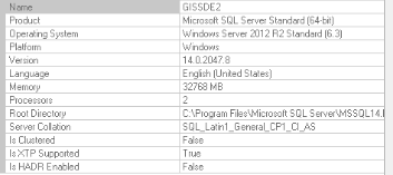

PeteJordan
Hey George, I did get that information for you.
Geodatabase Version: 10.6.0 (and can be upgraded and that is in the talks)
SQL Server Version: 14.0.2014.8
This might help as well:
Thanks
George_Thompson
Esri Notable Contributor
Ok, my hunch may have been correct....... you need to update the version of SQL Server to at least SQL 2016 to be on a supported version of SQL Server (https://enterprise.arcgis.com/en/system-requirements/latest/windows/database-requirements-sqlserver....).  I would recommend something newer like 2019 or 2022 for the SQL version to get more mileage. I do not think that version of SQL Server has been supported since before Enterprise 10.9.1 / Pro 2.9 in terms of our clients and DBMS combinations.
I would look at upgrading the geodatabase to a newer version: https://pro.arcgis.com/en/pro-app/latest/help/data/geodatabases/manage-sql-server/upgrade-geodatabas...
I would also make sure that you verify any dependencies on the geodatabases to other GIS systems, like Enterprise.
--- George T.
PeteJordan
Thanks George,
  The database admins are going to discuss upgrading, but have to check out a few things first.  I think they one thing was moving over to PostGres from SQL, so maybe that was why it hasn't been updated.  They also want to check about any other issues it could impact if they do update it and such.
  Anyways I passed on the information.  Thanks for your help and will let you know if that is in fact the solution if it does get updated to a newer version...
