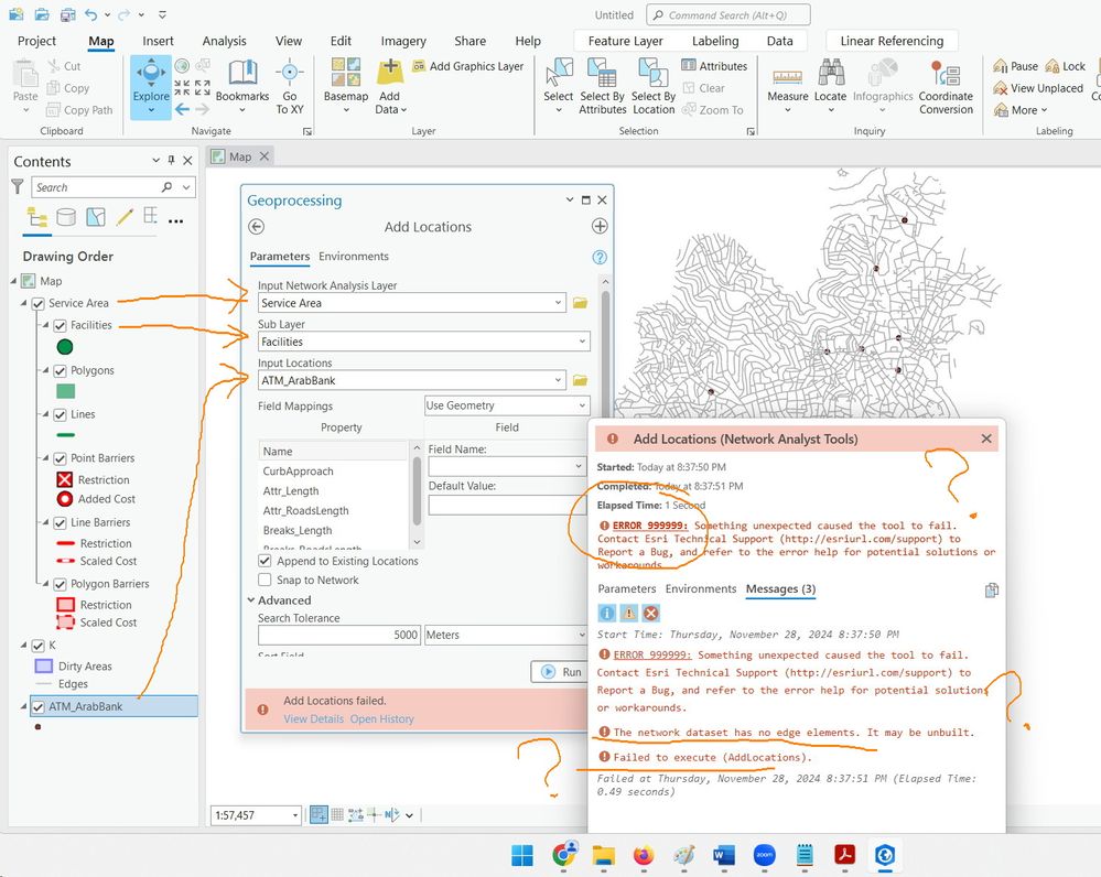

I couldn’t figure out why the "add locations" tool fails and results in "ERROR 999999."
What could be the issue here?

Error 999999 indicates there is no exception handling in place for the issue. There are a range of general causes that could result in this:
https://pro.arcgis.com/en/pro-app/latest/tool-reference/tool-errors-and-warnings/999001-999999/tool-...
https://support.esri.com/en-us/knowledge-base/error-error-999999-something-unexpected-caused-the-too...

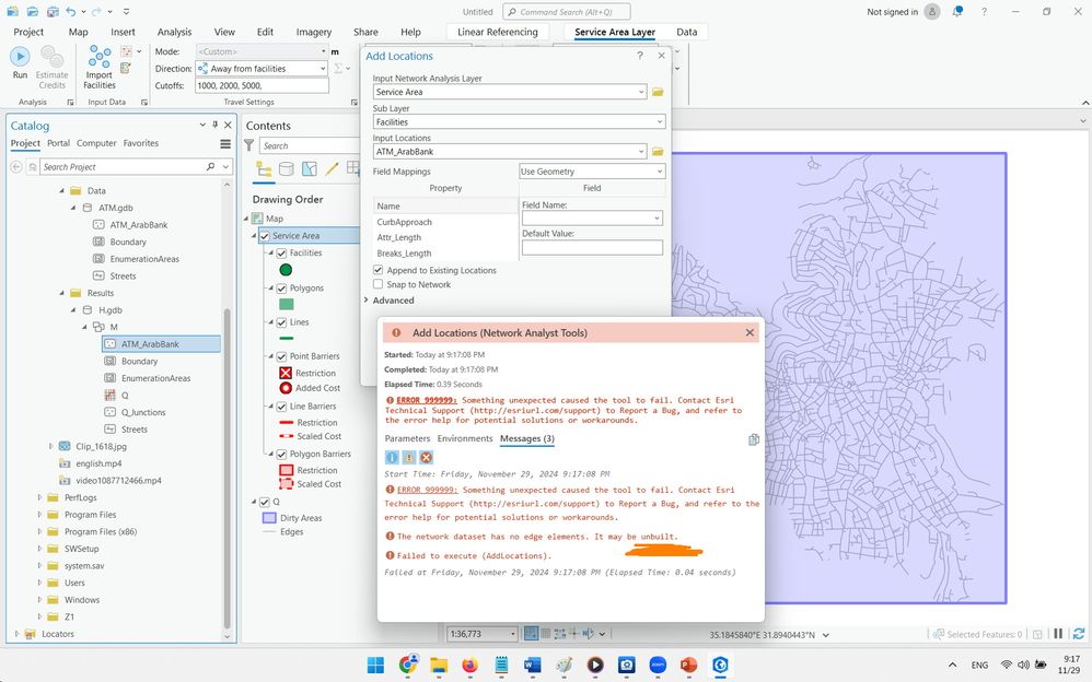

The additional message 'network dataset has no edge elements' gives some search results indicating users had geometry issues with their network:
https://community.esri.com/t5/arcgis-network-analyst-questions/quot-the-network-dataset-has-no-edge-...
https://support.esri.com/en-us/knowledge-base/error-the-network-dataset-has-no-edge-elements-it-may-...
As it's the first suggestion in the error 999999 handling for Pro and other users have had some success, I'd suggest running the 'repair geometry' tool, noting that doing so will update the dataset directly.

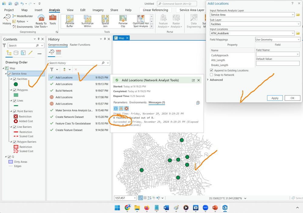

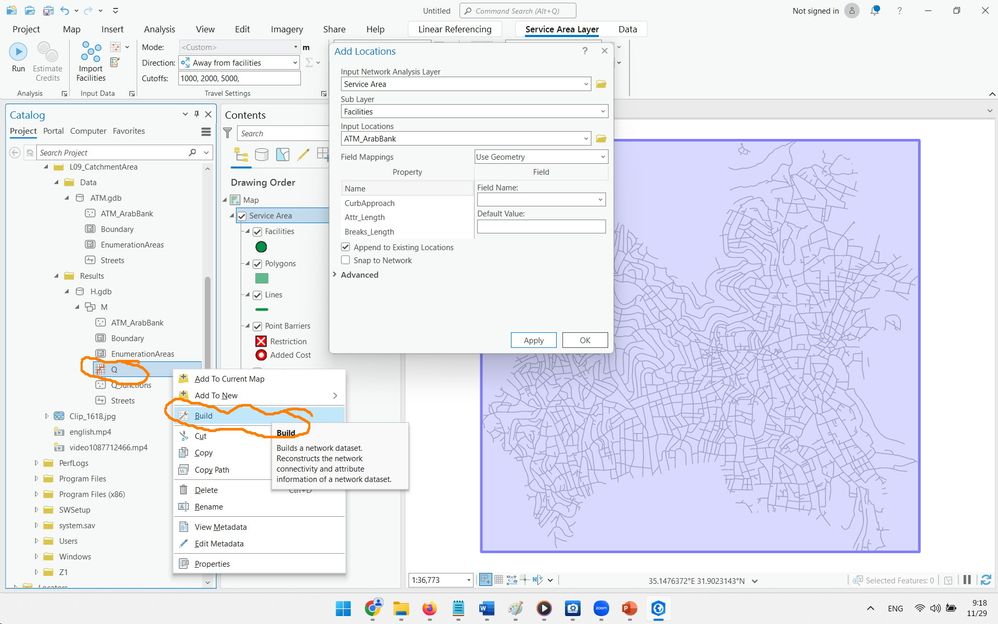

Many thanks for your input. It seems that the 'build' tool has resolved the issue.
