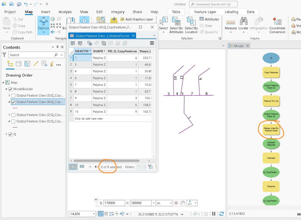

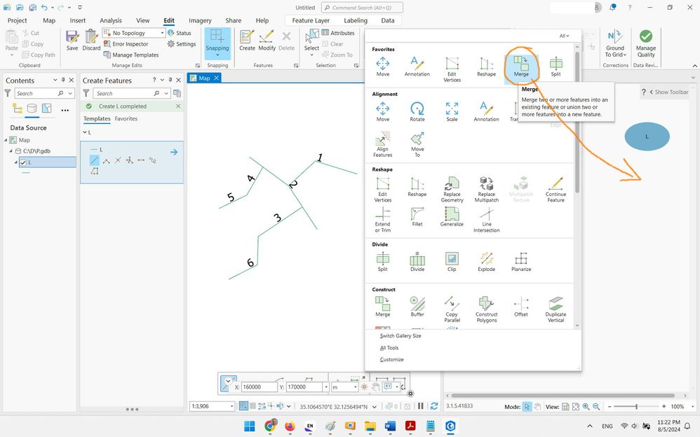

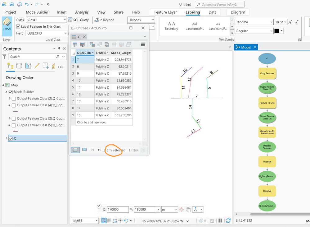

I couldn't figure out which tool in model builder can be used to merge all lines in one go. The lines with pseudo nodes need to be merged.

Hi Jamal,
There is a Merge Lines By Pseudo Node tool. It requires a Production Mapping license.
https://pro.arcgis.com/en/pro-app/3.1/tool-reference/topographic-production/merge-lines-by-pseudo-no...

Thank you for the help. It works fine

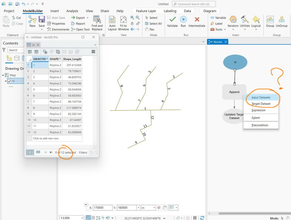

It appears that the “append” tool requires two input layers. All I need is to merge the lines between any two intersections (merging pseudo nodes).
Does it still work in this case?
