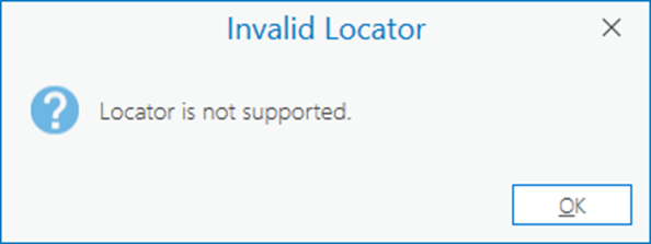

Hello - I keep removing locator files\objects that no longer exist (the ones that show a red !) from the Catalog pane in Pro 3.0 by right-click>remove from project.
But the locator files keep re-appearing no matter how many times  I remove them.  As a result, every time I try to switch to another project without exiting Pro first, I get an 'Invalid Locator' warning box that will not close no matter how many times I click it forcing a shutdown of Pro from Task Manager:

It sounds like your projects contain the classic locators that were deprecated in ArcGIS Pro 3.0, so this message will pop up for each classic locator (*.loc, *.loc.xml, *.lox) that is not a service referenced in the project. These locators will need to be recreated using the Create Locator or Create Feature Locator tool (*.loc, *.loz). To avoid these errors with your projects you would need to open them in Pro 2.9 and remove them and save the project before opening them in Pro 3.0. Geocode services that are based on the classic locator can still be added to the project and used. https://pro.arcgis.com/en/pro-app/latest/get-started/migrate-2x-to-3.htm#ESRI_SECTION1_CAF5C09ED07F4...
When you have opened your existing projects in Pro 3.0 and removed them from the Locators group in the Catalog pane have you saved the project and after saving you are still prompted with the invalid locator message? I would also double check for the invalid locators in the Provider Settings if you are able to access it in the Locate pane.
