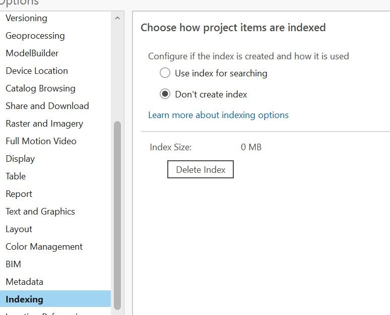

Probably have to disable everything again like stupid indexing...
JamiePetersen
I found this thread and disabled indexing.  This worked for me.

JamiePetersen
@AmberConverse you should try disabling the local indexing to see if that makes a difference for you.  It was immediately faster to rename after doing so.
AmberConverse
@JamiePetersen sadly, I've already done this.  And it is still slow for me relative to desktop.  Sigh.
