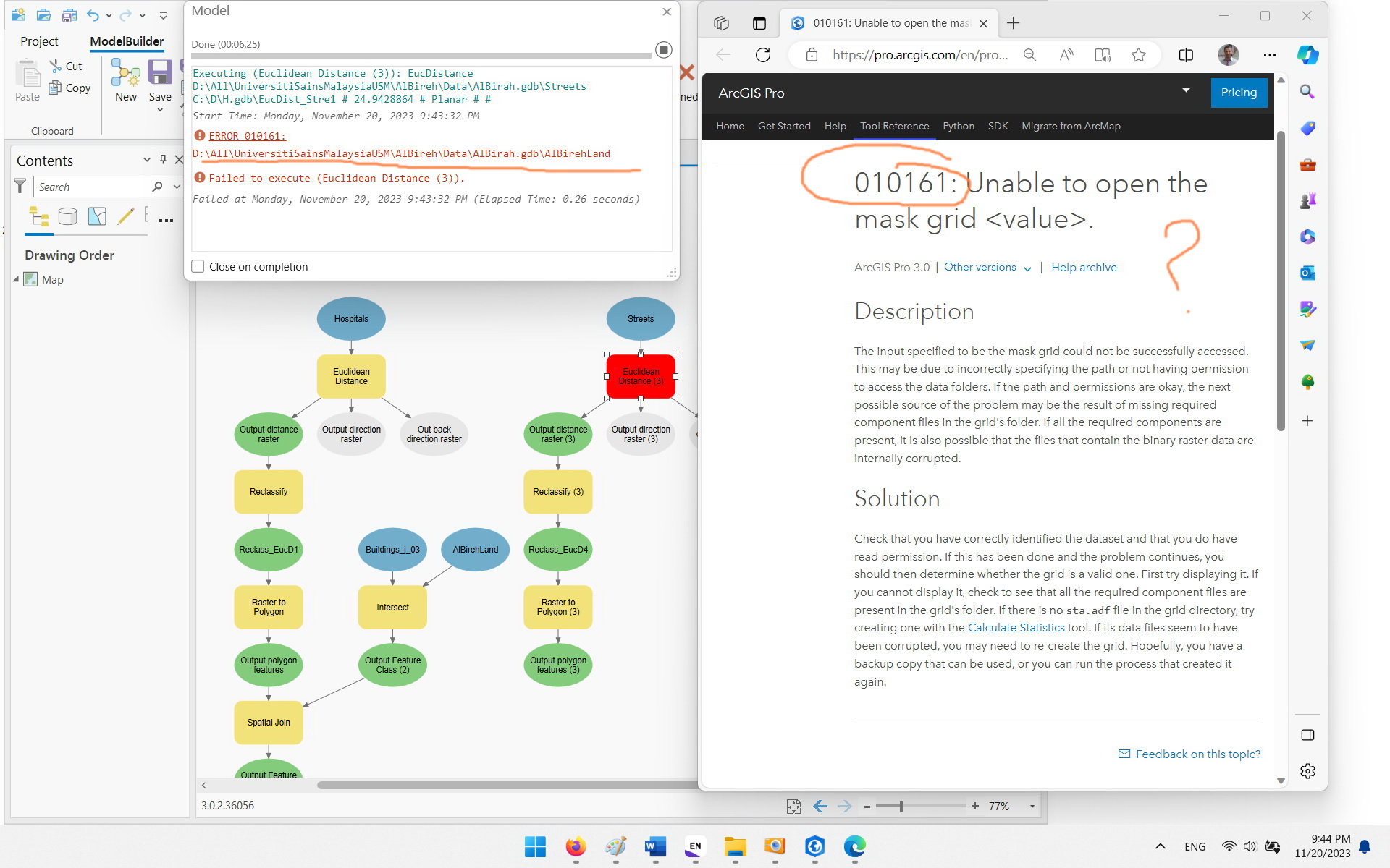

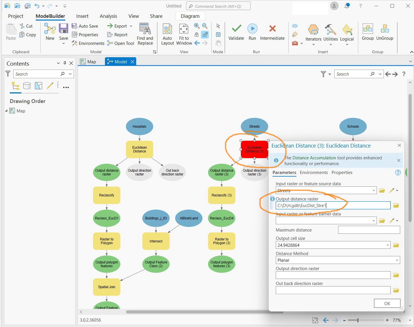

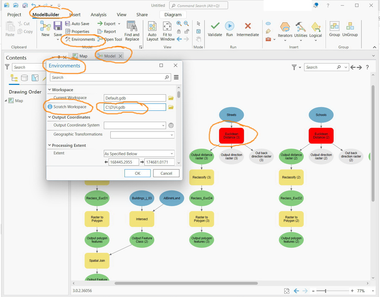

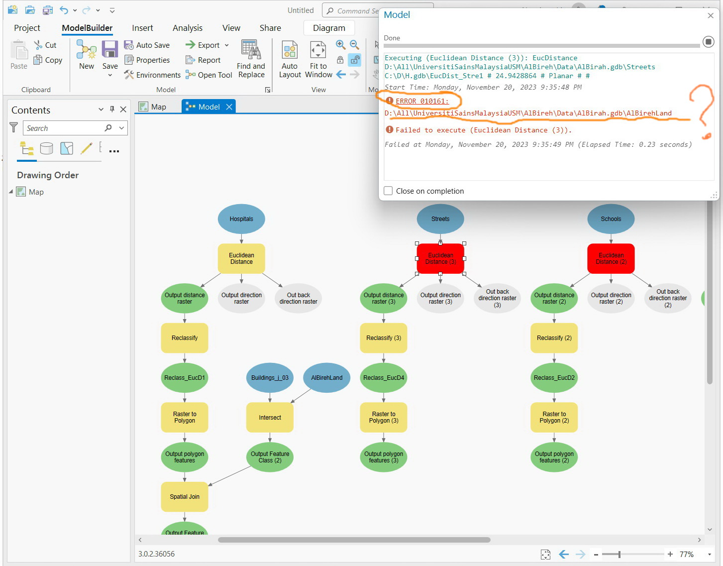

Despite the fact that the environment scratch workspace is set properly, the tools in model builder fails and end up with 010161 error as per the screenshots below
What could be the issue here?
Why does the error show a path that is different from the one set in the environment scratch workspace?
Is this a bug?

Do you get the same issue when running this as a python script? You can export your model to a .py file via the export option shown below.
Can I also confirm if the displayed file path in your 2nd image with the 010161 error is the path to your default file geodatabase?

I found out that the issue is with the mask set in the environment. This error persists to exist if the aprx file is open from different machine.
