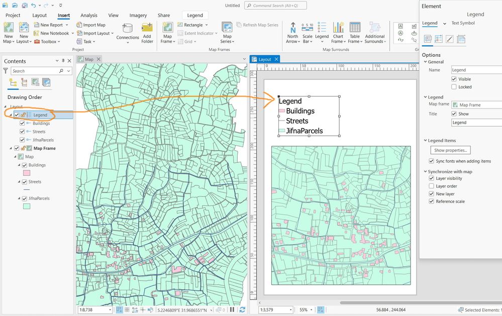

In the screenshot below, I wanted to remove the JifnaParcels from the legend but still having it visible on the map.
How this might be performed?

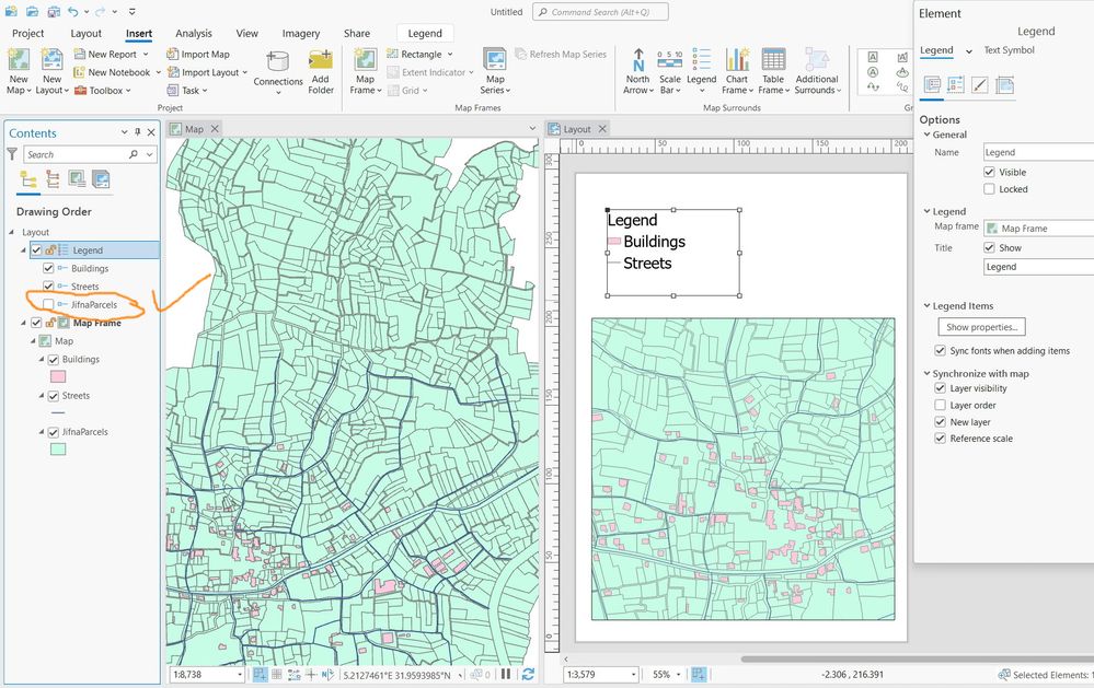

Hi Jamal,
Uncheck the box for JifnaParcels under the legend.
Only checked items will appear on the legend.

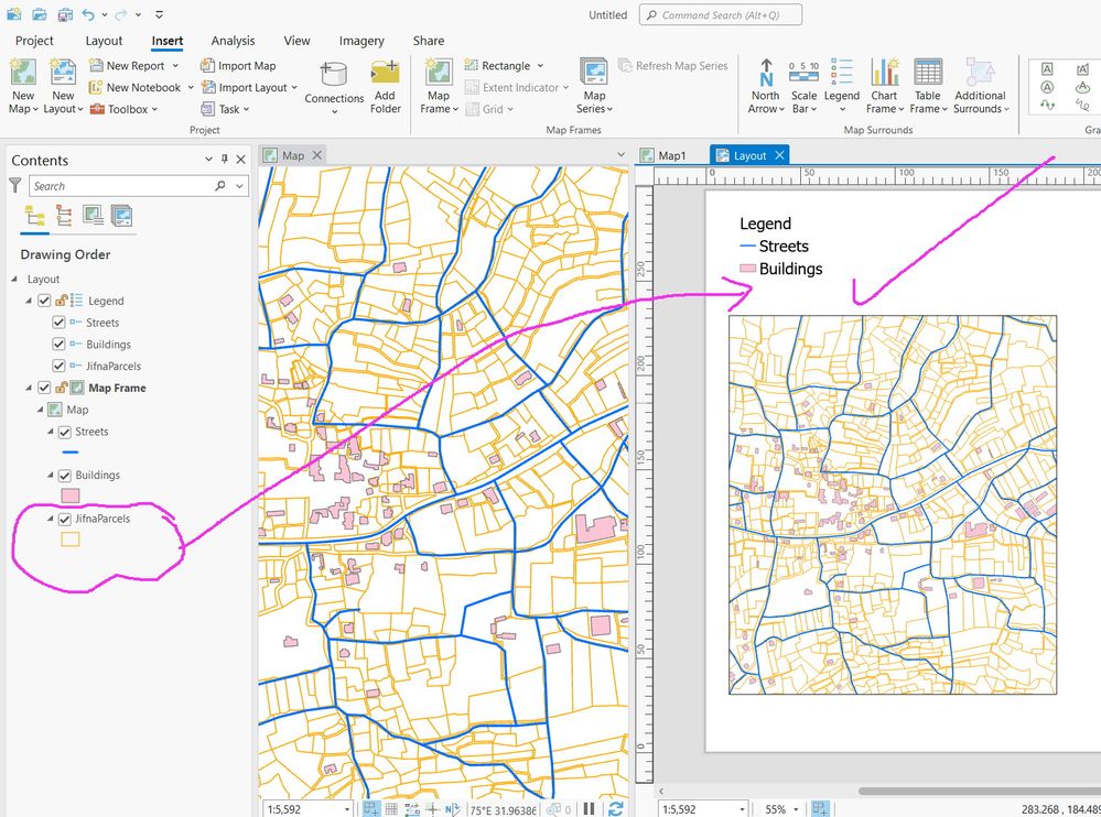

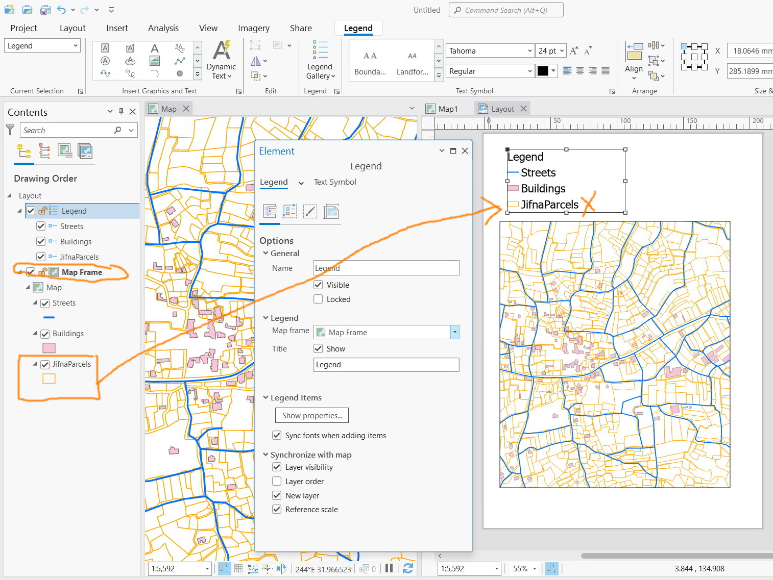

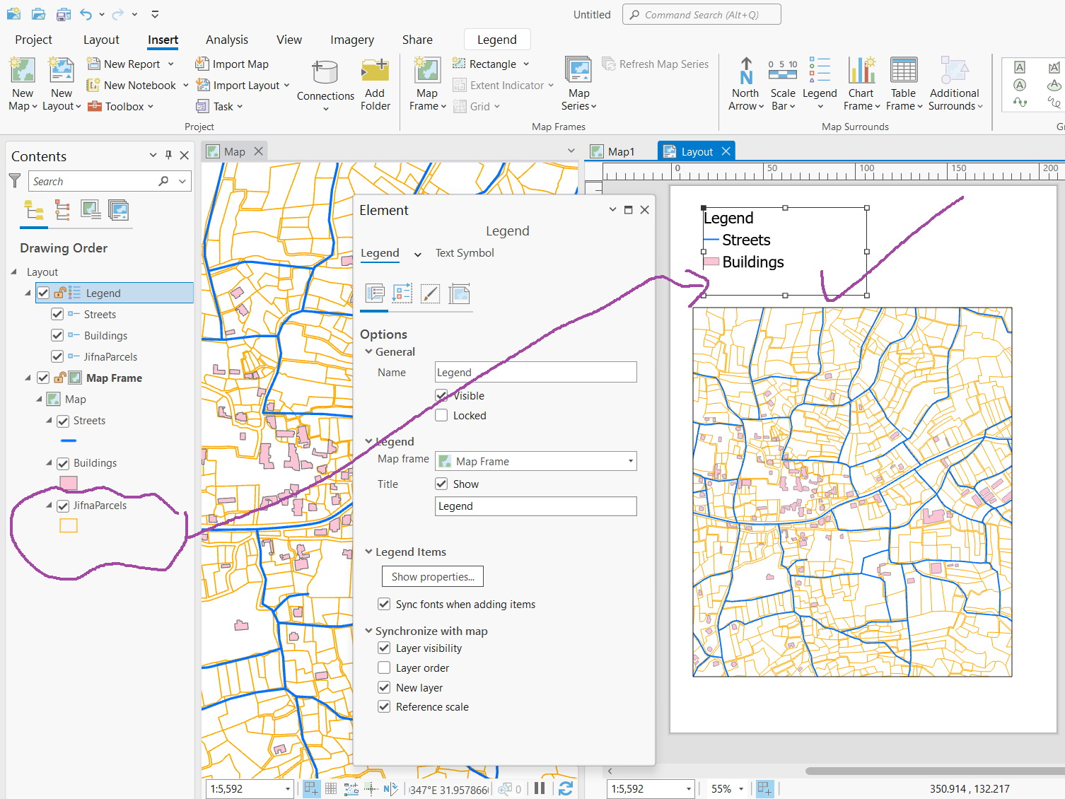

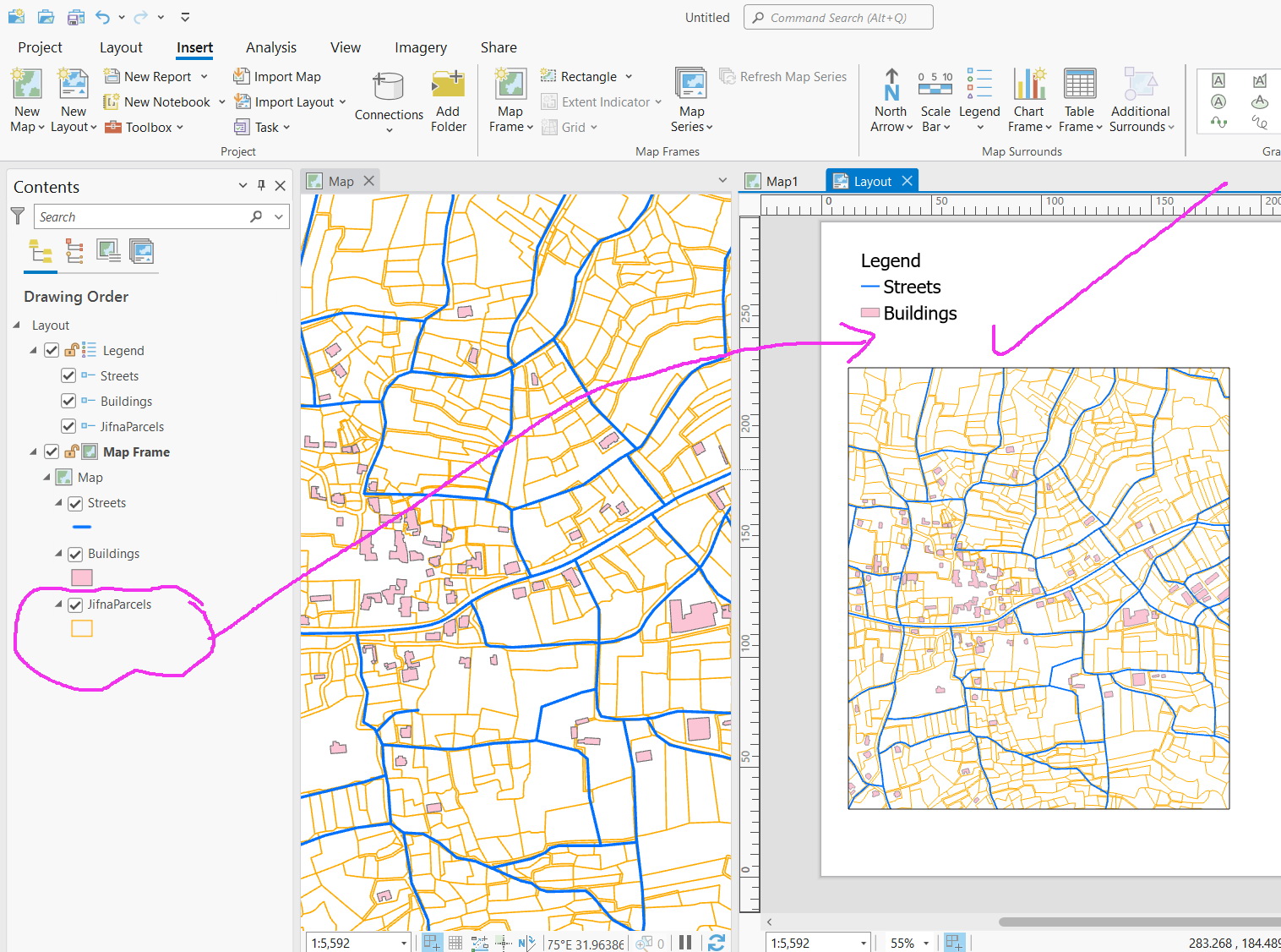

Hi Jamal,
I would right click on the JifnaParcels layer in the legend and click 'Remove'. This allows the layer to still show in the map (if it is on in Contents), but not be shown in the legend.
Original map:
Turning off the legend layer:
Final map showing all the layers, but only two in the legend:
