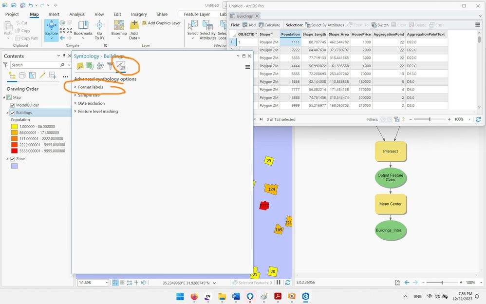

In the screenshot below, I intended to display the comma separator and set the number of decimal places for the numbers appearing in the legend. It appears that the code below has no effect.
Text($feature.Population, '#,##0')
What could be the issue here?

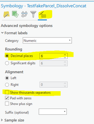

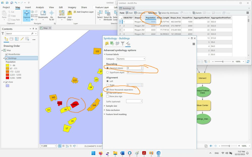

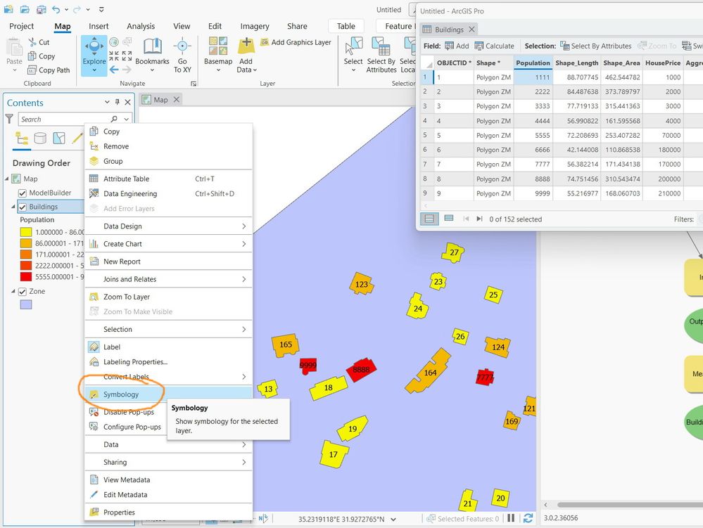

You should be able to adjust the label formatting in the symbology properties.

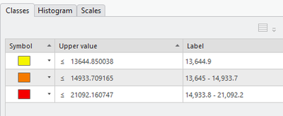

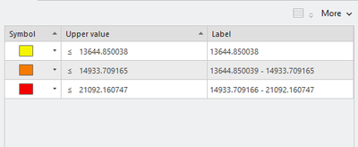

Before:
Settings:
After:
Before:
Settings:
After:
