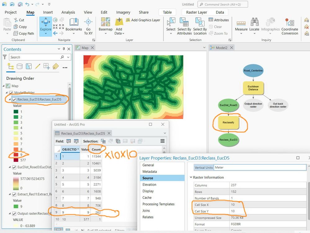

For example, in the screenshot below, class#9 has 262 cells. Thus, its area is 262x10x10.
How the “cell size” can be identified from the raster so that it can be multiplied by the “count” in order to calculate the area of each class?

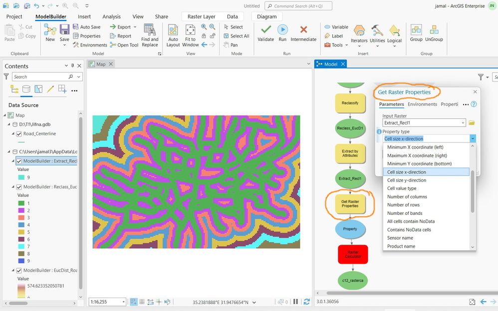

Check out this tool Get Raster Properties (Data Management)—ArcGIS Pro | Documentation

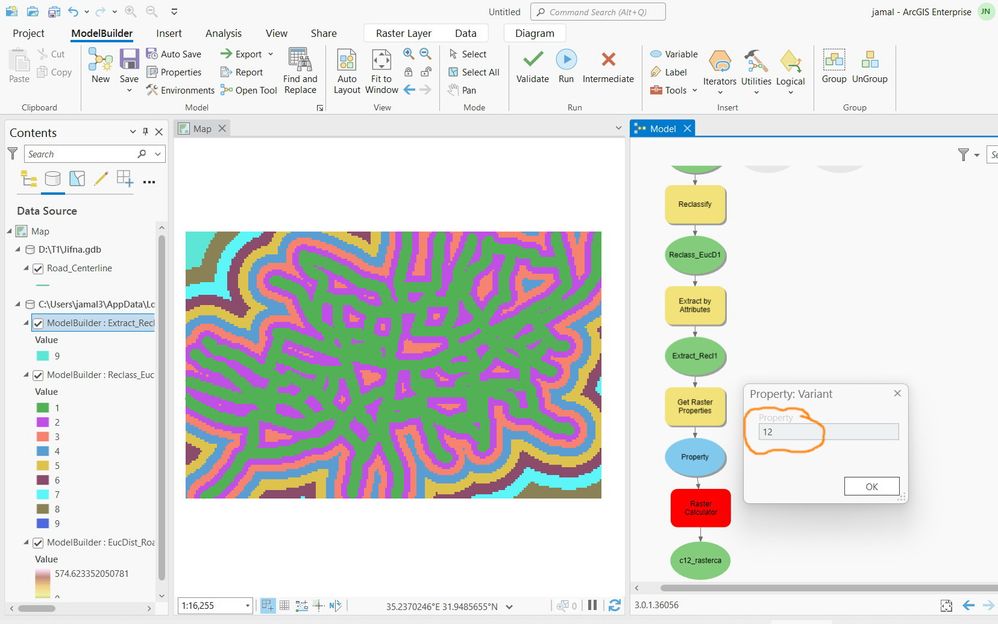

Thank you for the help.

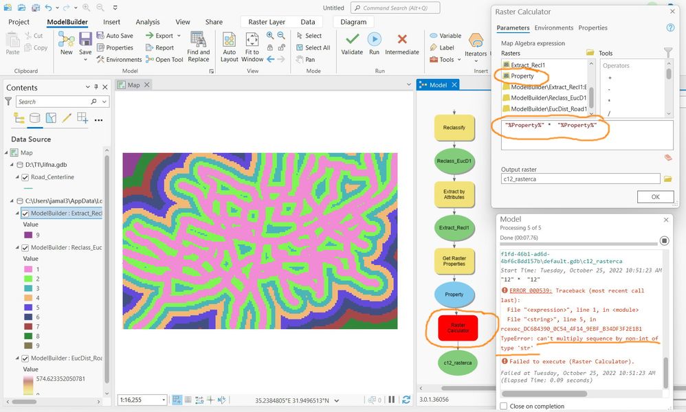

As per the screenshot below, the “raster calculator” tool fails to calculate the area of the cell that’s assumed to be computed by multiplying the cell size by the cell size (12X12).
How area of the cell can be calculated?
