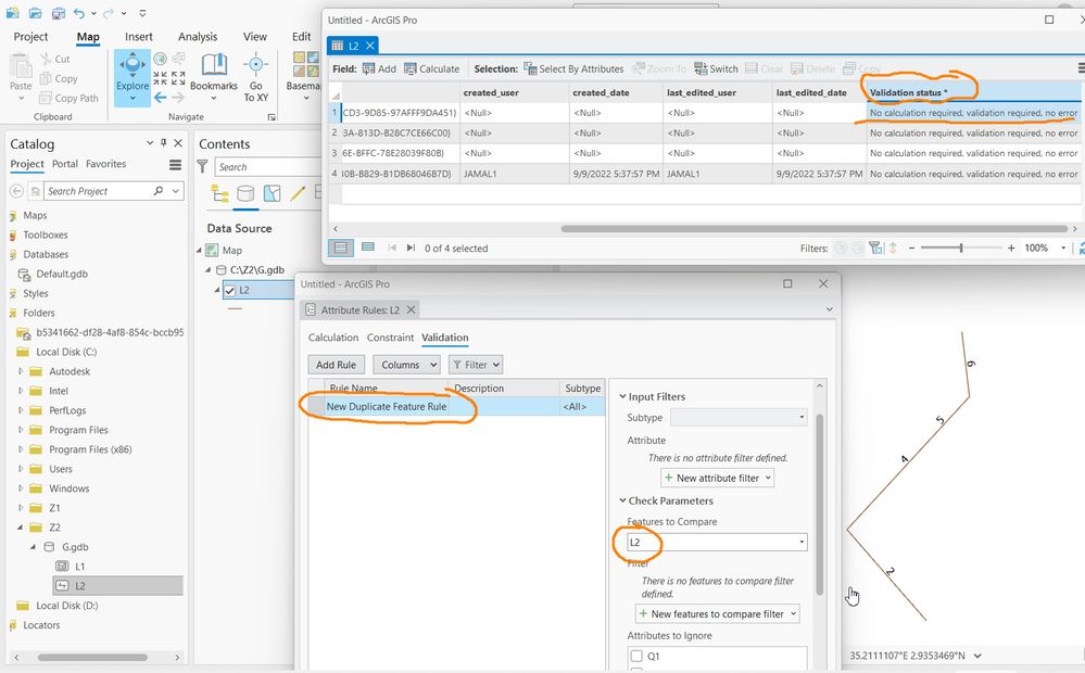

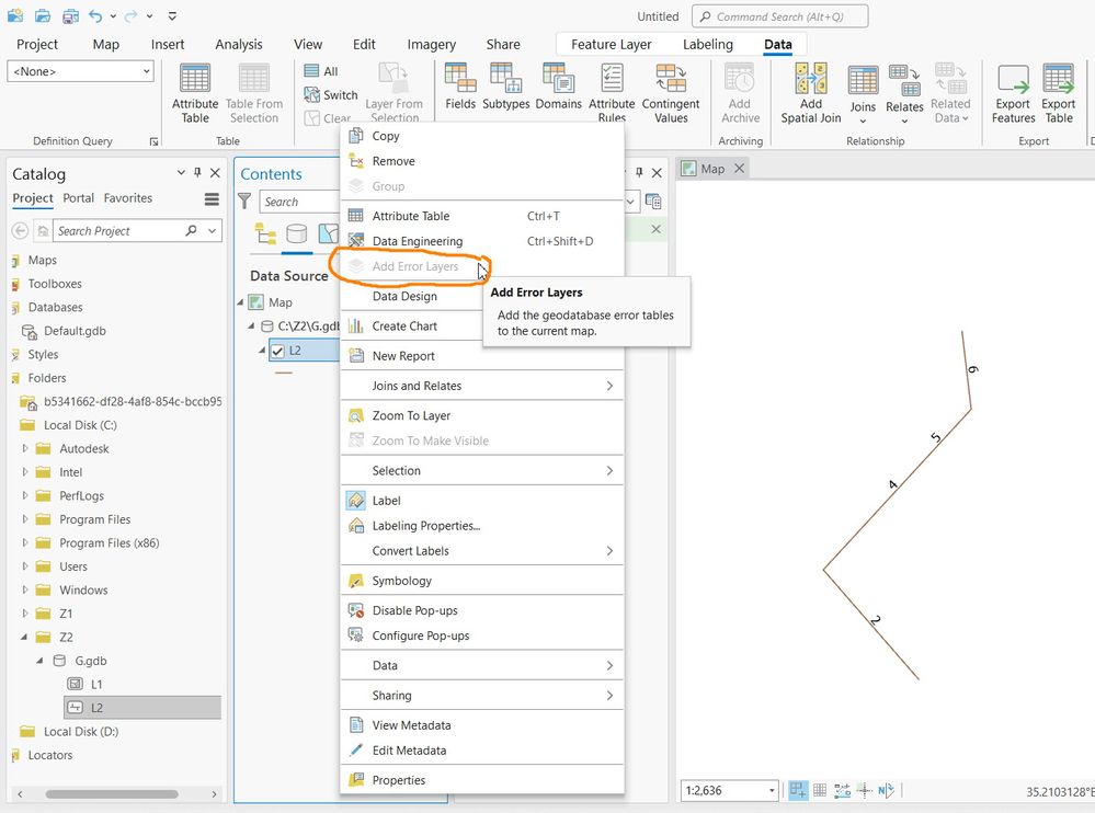

As per the screenshots below, I couldn’t figure out why the “add error layers” option is grayed out despite the fact that the validation attribute field is configured
What might be the issue here?
